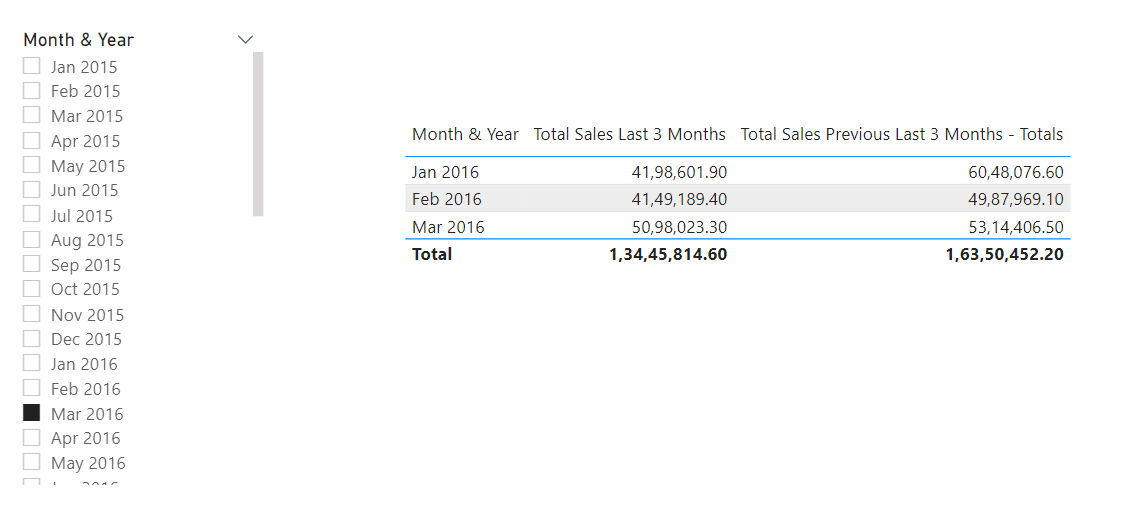

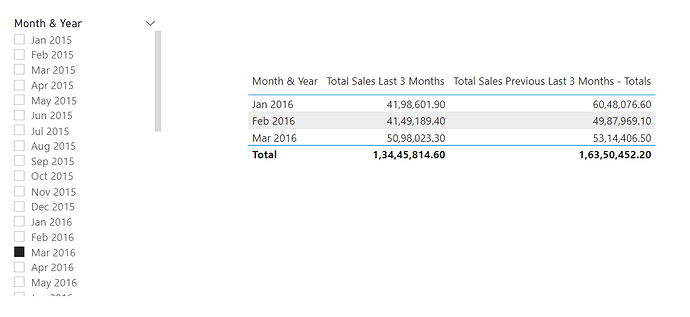

Below is the screenshot of the final results provided for the reference -
