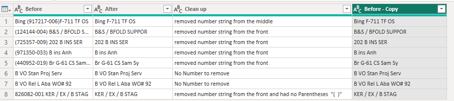

see [Before - Copy] column … right most column:
let
    Source = Excel.Workbook(File.Contents("C:\TEMP\EDNA\PQ_RemoveJ_No.xlsx"), null, true),
    Sheet1_Sheet = Source{[Item="Sheet1",Kind="Sheet"]}[Data],
    #"Changed Type" = Table.TransformColumnTypes(Sheet1_Sheet,{{"Column1", type text}, {"Column2", type text}, {"Column3", type text}}),
    #"Promoted Headers" = Table.PromoteHeaders(#"Changed Type", [PromoteAllScalars=true]),
    #"Changed Type1" = Table.TransformColumnTypes(#"Promoted Headers",{{"Before", type text}, {"After", type text}, {"Clean up", type text}}),
    #"Duplicated Column" = Table.DuplicateColumn(#"Changed Type1", "Before", "Before - Copy"),
    #"Cleaned (numbers & -)" = Table.TransformColumns(#"Duplicated Column",  {{"Before - Copy",each Text.Combine(List.Select(Splitter.SplitTextByAnyDelimiter({" (","(",") ",")"})(_), each Text.Remove(_, {"0".."9", "-"}) <> "")," "), type text}}),
    #"Cleaned numbers & -" =   Table.TransformColumns(#"Cleaned (numbers & -)",{{"Before - Copy",each Text.Combine(List.Select(Splitter.SplitTextByDelimiter(" ")(_), each Text.Remove(_, {"0".."9"}) <> "-")," "), type text}})
in
    #"Cleaned numbers & -"```
@SoftwareTrain - your code worked as well, for the first part. where it removed
the following “(######-###)” .
Thank you for the help,
Frankee

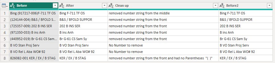

@Matthias - BTW - went back to your code…second part where you offered “NEW COLUMN” :slight_smile: …doe.
and that worked too. as opposed to me duplicating the column.
Again, right most column:
let
    #"Added After" = Table.AddColumn( #"Changed Type1", "Before2", each Text.Combine(List.Select(Splitter.SplitTextByAnyDelimiter({" (","(",") ",")"})([Before]), each Text.Remove(_, {"0".."9", "-"}) <> "")," ")),
    #"Cleaned numbers & -" = Table.TransformColumns(#"Added After",{{"Before2",each Text.Combine(List.Select(Splitter.SplitTextByDelimiter(" ")(_), each Text.Remove(_, {"0".."9"}) <> "-")," "), type text}})
in
thank you again,
