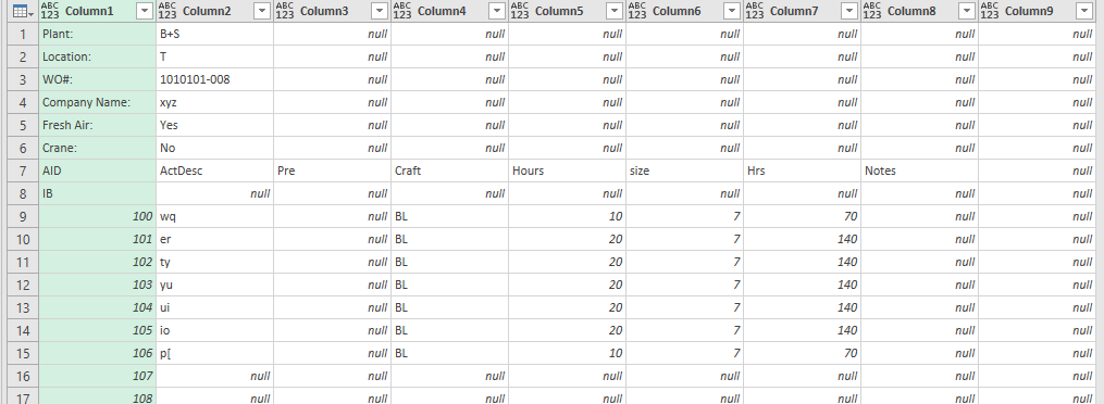

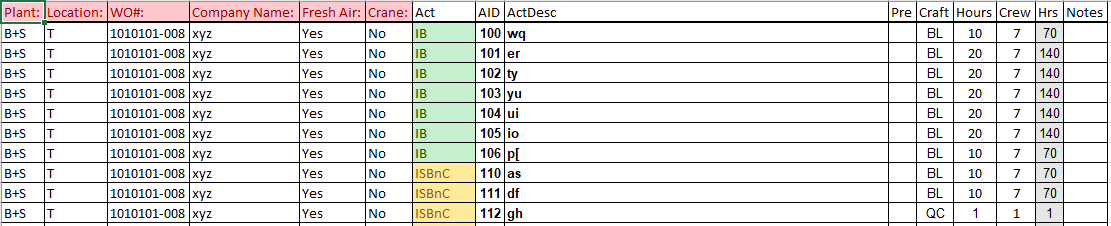

HELLO EDNA - looking for some help with a power query challenge. unable to move column, first 6 rows into new columns.
would like this:
to look like this:
tried for hours…no luck.
column 1 rows 1-6 should be header (6 additional columns)
column 1-8 row 7 should be header
column 1, row 8 and 9 should be header two separate columns (text and numbers) (this should give us two additional columns.
sample data attached.
thank you for any help in advance,

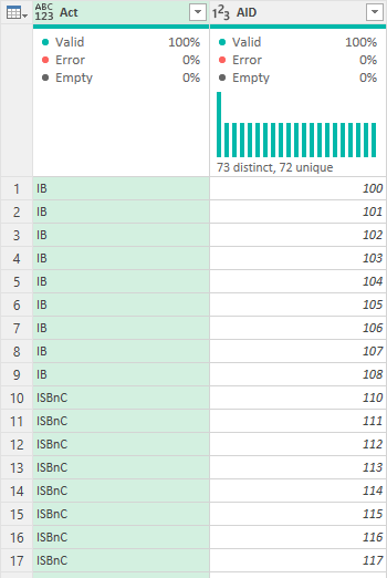

Step 1
Step 2
Step 3
  • remove top 7 rows
  • keep only column 1
  • Duplicate column 1 as AID
  • Change data type on AID to numbers
  • replace errors with null
  • Add conditional column Act, if AID = null then Column1 else null
  • Fill Down on Act
  • remove nulls on AID
  • Keep only Act & AID
Step 4
Step 5

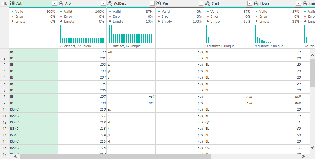

  • Append Step 1 and Step 4
  • Fill Down all columns from Step 1
  • Remove Nulls from AID column
  • Close and Load

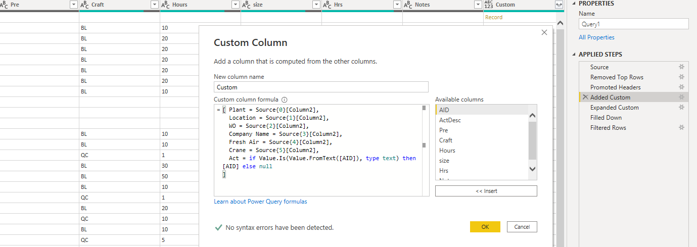

Hi @Frankee
If you know how to reference a cell, its easy.
Create a record(Custom column) as below, Just in one step you will get all the required columns.
First Few Rows to Columns.pbix (36.9 KB)

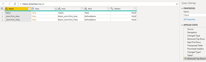

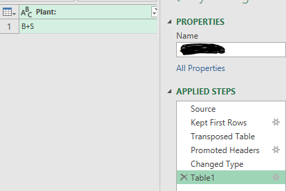

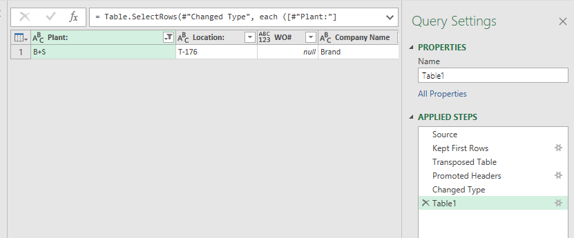

Hey JC - thanks for looking into this for me. I was unable to follow @ this step “table”
I saw the filter for 6 row…but could not figure out the “Table1” step. how do you create this step?
Hi @Frankee,
The code for that step reads:
Table1 = Table.SelectRows(#"Changed Type", each ([#"Plant:"] = "B+S"))
So in the UI a filter was placed on the colum [#“Plant:”], you can recreate this via the arrow in the column header, which will show a context menu (very similair to how you would place a filter in an excel table). The name of the step generated by the UI was renamed, to make it easier to find and refer to later on.
I hope this is helpful

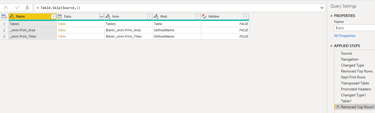

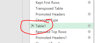

Hey @Melissa - thanks for your replay and help. I’m going to try all three. right now I’m hung up on the first solution.
so How do I create the 2nd step. In that 2nd step , I’m to remove top 6 rows, but I don’t see that…I’m only left with one row due to the filter in table 1.
Great stuff…
Do you have the formula bar visible on your screen? If not, go to the View tab and toggle it on :+1:
You’ll see the code for that step reads:
= Table.Skip(Source,6),
Source is a table reference, you’ll find that all the way at the top in the Applied Steps pane. You can refer to any step or even another query - again this code was manually adjusted.
If you select the operation/transformation/action on the ribbon (Remove Rows/Remove top rows), you can adjust the code in the formula bar afterwards. That way you don’t have to write or know all the M functions :wink:
@Melissa , sorry but I don’t follow. I do see the tool bar.
I need to remove 6 rows. but I only see one row.
looks to me like I have to get back to before “Keep First Rows”…which was the 1st step.
Okay I know that’s confusing…
Just select Remove Rows / Remove top rows (and enter a 1 in the dialog box for example)
You’ll get an empty table BUT can now adjust the syntax in the formula bar into: Table.Skip(Source,6)
Calling the Source variable will bring back that table
Hope that helps
I see the “Table” in the Data column 1st row.
if I click on it, it expands to show original data.
:+1:
Excellent!
Looking at your steps you should replace Source with #"Changed Type"
To revert back to the table you used in building Table1.
All the best.

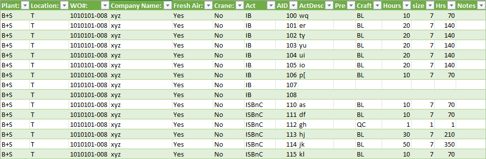

Melissa - appreciate the help as always. managed to figure out the “Merge Queries” step. Table I was on…3 only found it self. but I was able to update the table number in the formula bar…and it worked like magic. I partly wanted to go thru the manual , UI because my upload to EDNA was modified. it all worked out. so thank you al for your help.
