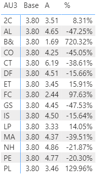

Hola EDNA - needed some help to make sure I’m calculating this correctly. I need to know the Percent delta between two numbers. measuring against a base line and how we perform against it.
  1. Base = AVERAGEX( XT ,XT[SF])
  2. A = DIVIDE([ActH],[EarnH])*[SF])
  3. % = CALCULATE( DIVIDE([Base], [A],0)-1
the goal is to stay below the base, the lower the better.
Secondly if the above measures look correct. I don’t want the AU3 to appear if I have no data in measures (Base & A), please see pic.
Thank you for your help in advance,
Frankee.

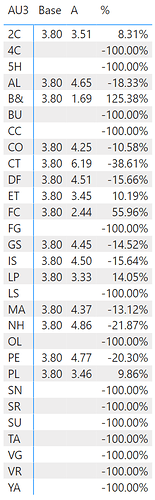

Managed to figure out the empty column challenge by following this tutorial:
Computing totals by summing visible values in DAX
SUMX(
    VALUES('Calendar'[WE]),
    CALCULATE(
        IF (
            DIVIDE([Base],[A],0)<>0,
            CALCULATE(
                    DIVIDE([Base],[A],0)-1
pic below of result

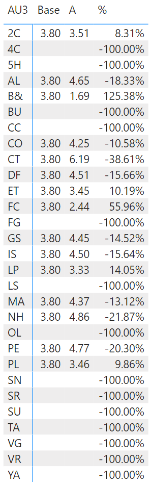

Only question still need help with is, the first…is % difference between two measures calculating correctly?
Thank you in advance,
Frankee
Hi @Frankee ,
If its giving the right number then its good .
some of the numbers are wrong. I’m expecting what’s in Green column. the yellow rows match closely …but not exact…if I increase the decimals places…they’re not identical.
again, thank you in advance.
Frankee

Sorry for delay in reply first i think is solved your problem and i am able to get your desired result as you may see in the below screen shot:
I am attaching the pbix which conation the solution :
DM-XT.pbix (198.4 KB)
Let me know if you have any question.
Hell @Anurag , no worries. looks like this was the solution. appreciate the help. typical, I complicated what I was doing.
