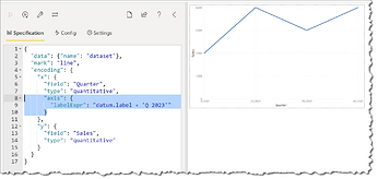

Hi @luz58. In Deneb, you can add an axis block to the x-encoding desired axis block complete with an expression to create the axis label you want. Here’s an example of creating your desired format:
  "data": {"name": "dataset"},
  "mark": "line",
  "encoding": {
    "x": {
      "field": "Quarter",
      "type": "quantitative",
      "axis": {
        "labelExpr": "datum.label + 'Q 2023'"
    "y": {
      "field": "Sales",
Hope this helps.
Greg
