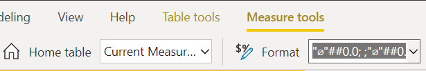

The only formatting solution I know is using the Format field in the Measure tools tab (s. example below). And that solution I can not apply because of the SWITCH function for sales, volumn and price.

You got it, and the reason I can’t change it is “For new Power BI Desktop models”.
So for existing reports I won’t be able to use FORMAT to get the desired formatting. But with all new reports, it should work for me (but then probably my US colleagues will see comma instead of dot).
That answers also why in contrast to FORMAT the US syntax used in the ribbon (s. picture) worked fine:
