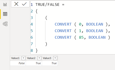

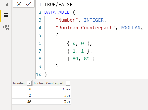

From the below images you can see that 0 is FALSE and non zero number is TRUE
