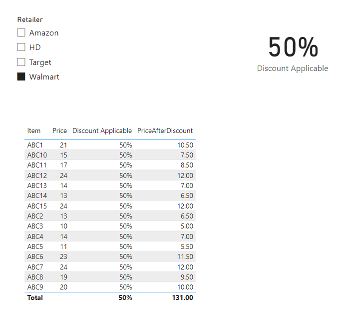

okay, I thought over it again and here is the solution if I understood your requirement correctly this time :
When no selection:
When selection is made
here is the key measure you can use:
PriceAfterDiscount =
VAR _percentage = SWITCH(TRUE(),
SELECTEDVALUE(Retailers[Retailer]) = "Amazon",0.4,
SELECTEDVALUE(Retailers[Retailer]) = "Walmart",0.5,
SELECTEDVALUE(Retailers[Retailer]) = "HD",0.55,
SELECTEDVALUE(Retailers[Retailer]) = "Target",0.45,
1)
VAR _price = SUM('New Sales'[Price])
VAR _sol = _percentage*_price
return
_sol
here is the PBX File forreference
Sale Discount_sol_jss.pbix (39.3 KB)
Hope this helps.
