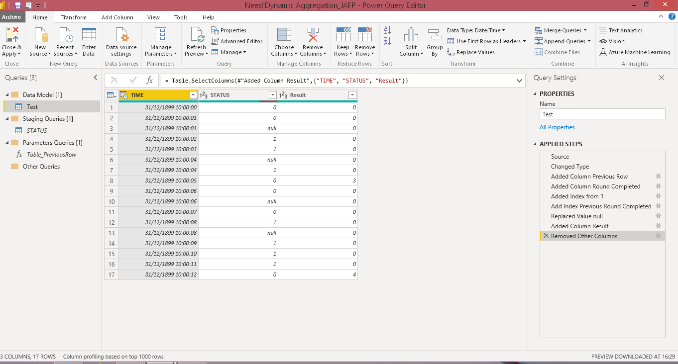

Hi @praveer82,
I send a possible solution to the problem you have raised.
I’ll explain the steps I’ve followed:

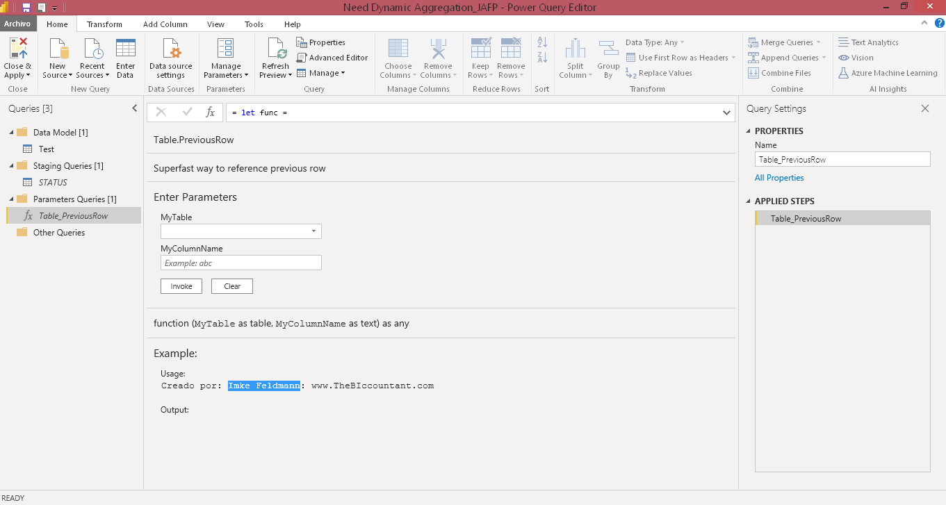

  1. Added Column Previous Row
    We add a calculated column with the STATUS value of the previous record.
    For this I have used a function called Table_PreviousRow created by Imke Feldmann, instead of using the creation of two indexes.
  1. Added Column Round Completed
    We add the Rounded Completed column which is 1 if the current STATUS value is 0 and the previous STATUS value is 1.
  2. Added Index from 1
    We add an index starting with 1, which we will use to determine the range of rows between a Full Round and the Previous Round.
  3. Add Index Previous Round Completed
    We add a column with the index of the last Complete Round for those records with Complete Round = 1.
  4. We remove null values ​​from the previous column.
  5. Added Column Result
    We add a column with the sum of the STATUS column for those rows whose index is between the index of the last Complete Round and the current index.
Finally we remove the fields we don’t need.
I hope you find it useful.
Need Dynamic Aggregation_JAFP.pbix (20.3 KB)
Greetings,
