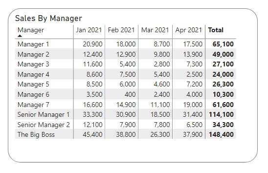

  2. A possible report looks as follows: (whereby sales of manager 7 is not added to another manager)
I hope this solution meets your requirements.
