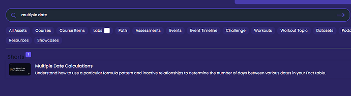

if i remember correct you can a multiply 1 to many relationships but only one can be active at a time. Userrelationship i believe is the dax formula that you will have to use to active the other date.
you will have to review the course on the education portal.
thanks
