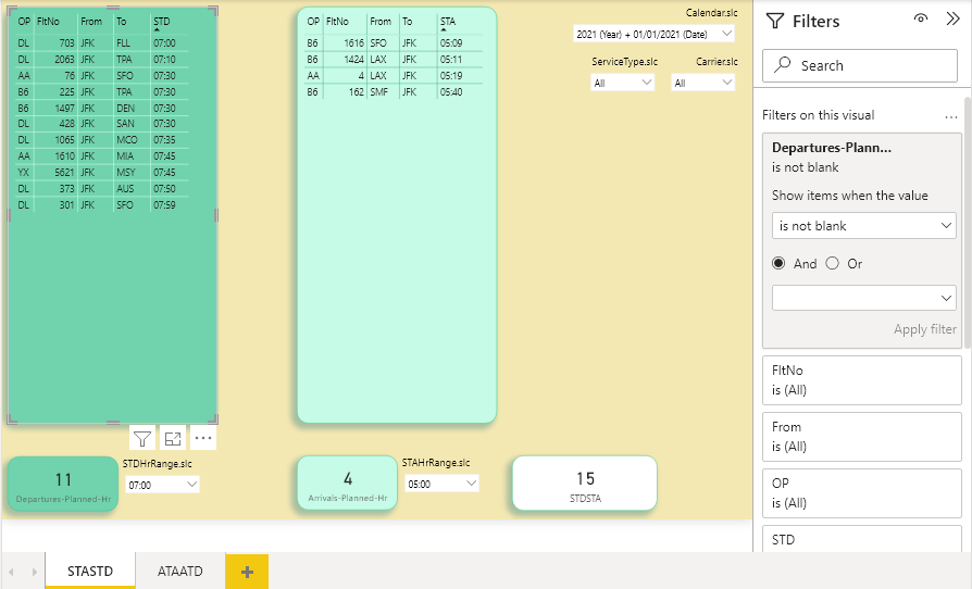

while we have solved the issue for items 5 & 6 of my earlier email, we still have not found the answers for items 1-4 which i believe is caused by the auto exist element. kindly refer to following samples
  1. sta-std
planned departures shud b 16 (instead of 11)
planned arrivals shud b 8 (instead of 5)
  1. ata-atd
actual departures shud b 5 (instead of 3)
i hope we can find a solution to that.
tks & krgds, -nik

There are only 11 departures from JFK and 5 arrivals at JFK.

hola @jafernandezpuga ,
indeed you are right!
the calculated results were correct for the counts of std & sta for the given example.
however, do u know why do the table visuals produce the ‘extra’/wrong info & how can we resolve that to show the correct list i.e. 11 & 5 flight info respectively for the std & sta for the selected date & time-range?

Hi @nikahafiz,
I have modified the measures so that the rest of the filters on the JFK table are not eliminated:
Arrivals-Actual =
CALCULATE(
    COUNTROWS( JFK ),
    KEEPFILTERS(JFK[DEST] = "JFK"),
    KEEPFILTERS(JFK[ATA] <> BLANK())
Arrivals-Planned =
CALCULATE(
    COUNTROWS( JFK ),
Departures-Actual =
CALCULATE(
    COUNTROWS( JFK ),
    KEEPFILTERS(JFK[ORIGIN] = "JFK"),
    KEEPFILTERS(JFK[ATD] <> BLANK())
Departures-Planned =
CALCULATE(
    COUNTROWS( JFK ),
To each table we add the corresponding measure that is not blank as a filter.
Regards,
211116.sample_Auto_Exist_JAFP.pbix (5.5 MB)
