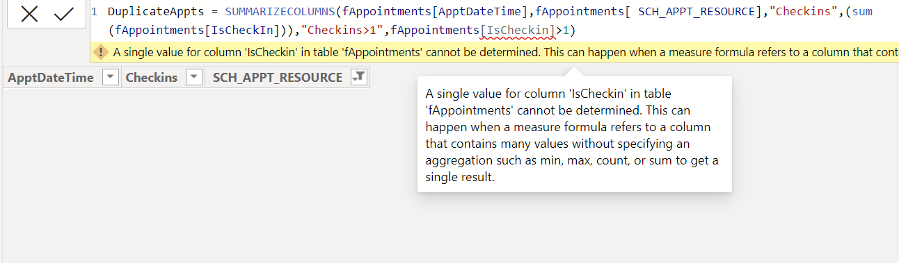

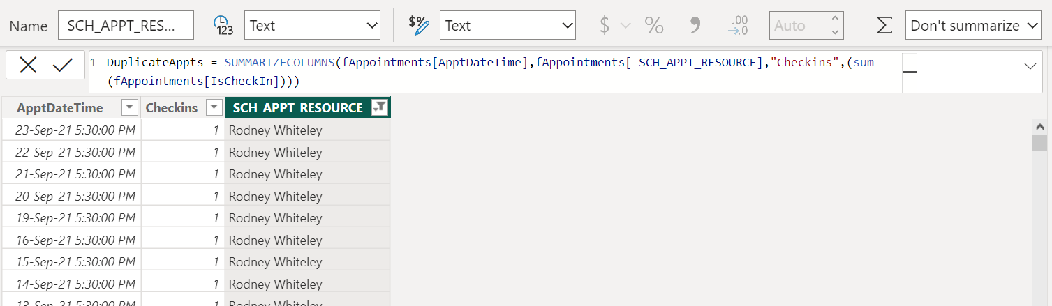

I figured I could created a virtual table with SUMMARIZECOLUMNS

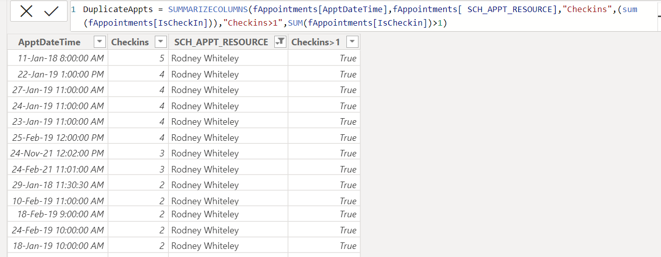

and then use a filter to aggregate the sum of the “Checkins” virtual column, and count the number of times this was >1 (meaning there was more than 1 checkin for that resource, and that date/time), but this fails if I try adding a filter getting an error as I have to pass a scalar:

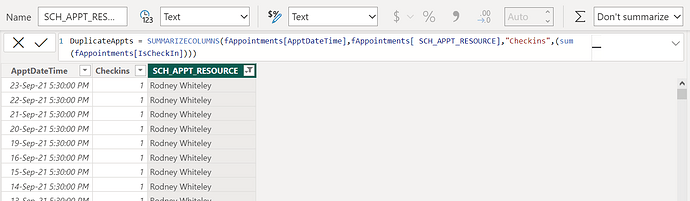

So if I wrap this in a SUM, the table evaluates:

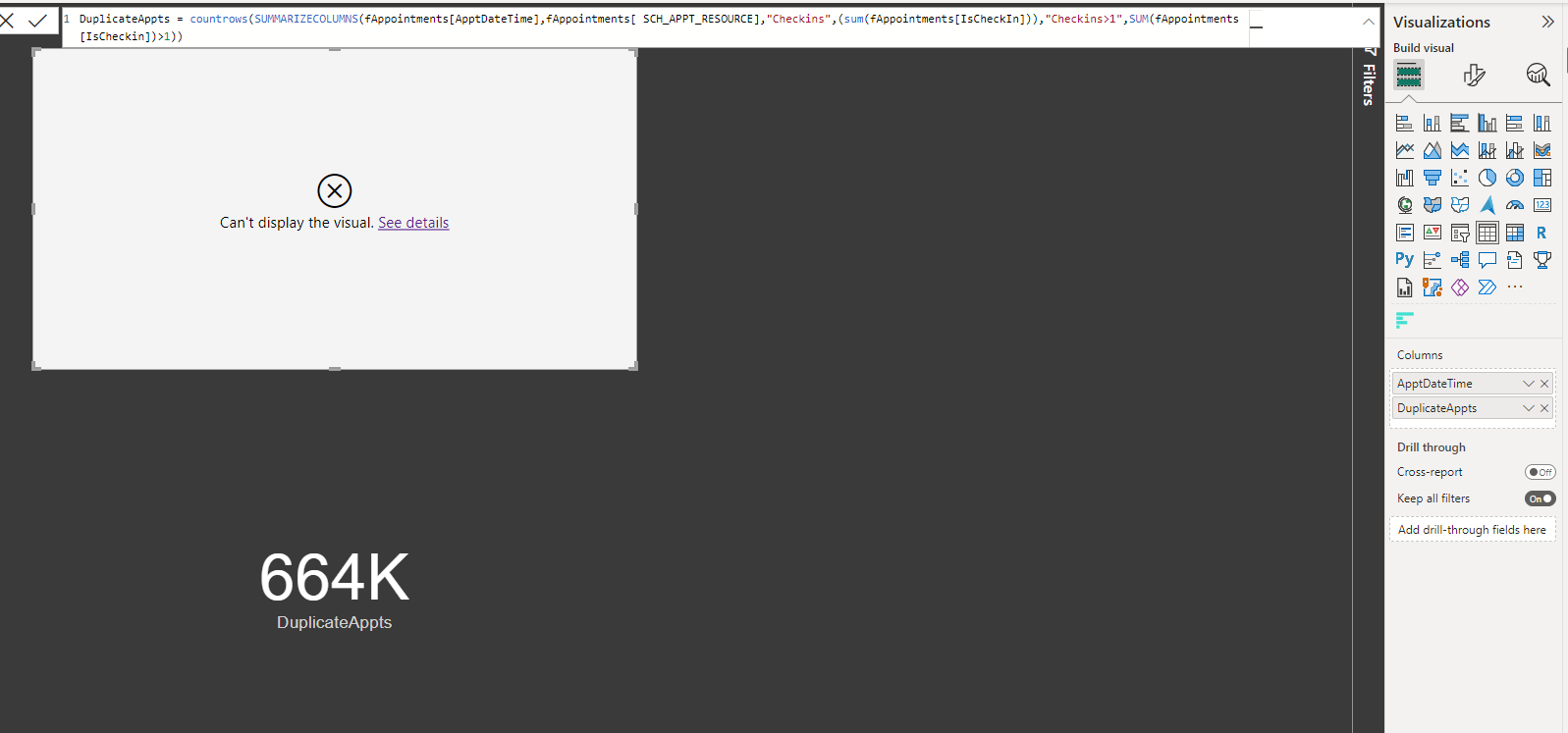

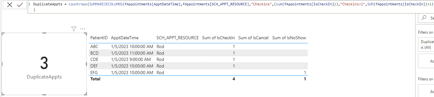

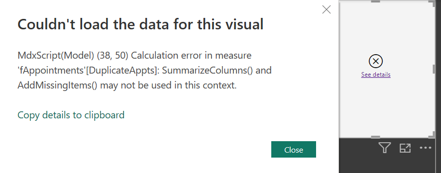

So I figured I could wrap this expression in a COUNTROWS to find out the number of times there were double-bookings (or worse) but it’s throwing an error I don’t understand:

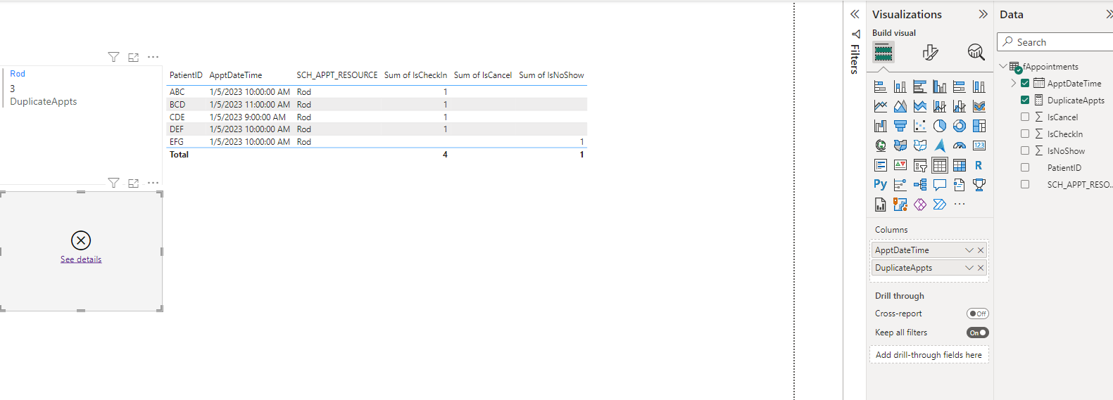

Note that it will evaluate if I place it on a visual by itself, but it fails if I try to add any other item to aggregate by (real data set has about 1M rows):

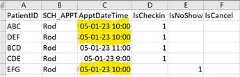

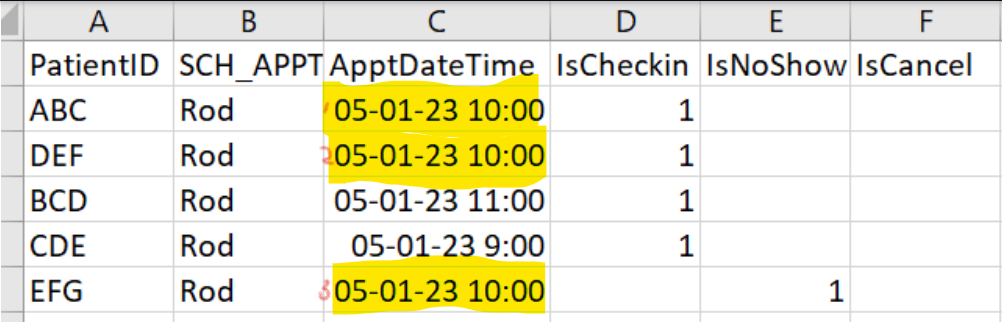

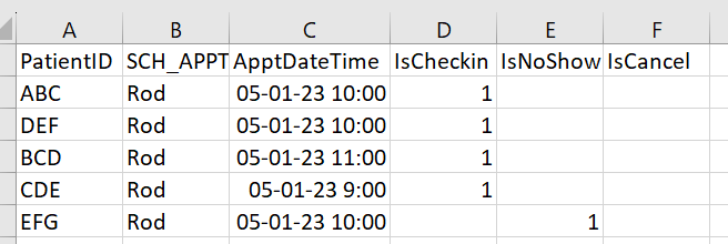

To try to figure this out, I created a ToyData set which has 1 double booking (10:00 AM, 5th January, 2023):

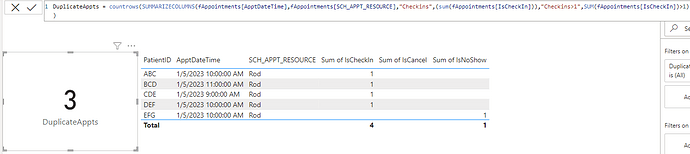

(and the PowerBI with the same measure now evaluates rather than throwing an error, but it’s telling me there are 3 “double-booking” rows (I think this should only evaluate to 2):
Weirdly, it will let me aggregate this by the Resource name, but not by the date field:

  1. Why I am getting an error when I try to place this in a visual with some values, but not others?
  2. Why is the measure evaluating in the Toy data set report, but giving me 3 for the count of duplicates?

@rodwhiteley,
I think I understand your needs, but can you clarify why this should be two double bookings rather than three:
Is it because you want to exclude those where isNoShow == 1? If that is the case, then the answer to your question,
is because you aren’t excluding no-shows in your measure.
Maybe the criteria for a double-booking are:
  1. isCheckIn == 1
  2. isNoShow and isCancel are both not equal to 1
  3. The same SCH_APPT_RESOURCE has the same ApptDateTime
if that’s the case, you could approach this by
Filtering the data based on the criteria given,
Grouping the data by ‘SCH_APPT_RESOURCE’ and ‘ApptDateTime’, and
Counting occurrences that are more than one.

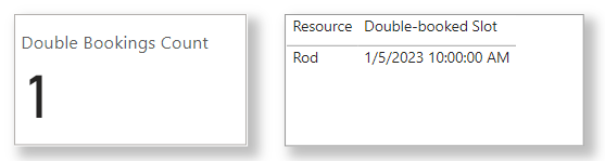

Then you could get the count of double-bookings:
Thanks for the reply. They should only be double bookings when the state is “IsCheckIn” (there’s another that’s not checked in so it shouldn’t count for this)
@rodwhiteley
okay, perhaps the measure i shared will work for you then.
Thanks indeed. Works perfectly, I really appreciate your help.
