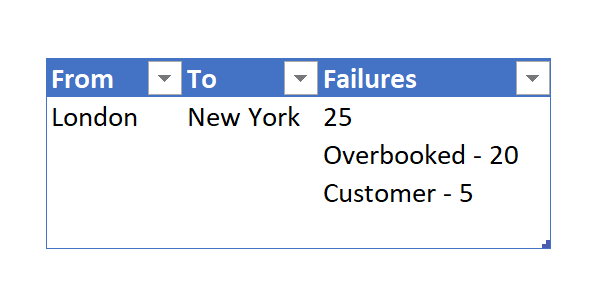

I’ll use the image of my PBIX table with the London New York example which has 25 container failures which is summed using my measure Container Failures.
I’d love to create a measure where it will return the total no of failures which is 25 and then using Unichar 10 (I think) it will split to a new line and then break out/break down the no of containers by Failure Reason as per the image I created in Excel. It will return a new line for each group of Failure Reason. The number of failure reasons will be dynamic, I currently have 14 different types of failure reason but not sure if that number would expand or not.
If there were no failures I’d want a blank returned.

No worries, give this a go.
Container Failures TEXT =
VAR vTable = SUMMARIZE( Orders, Orders[From], Orders[To], Failures[failure_reason] )
RETURN
IF( ISINSCOPE( Orders[From] ),
    COMBINEVALUES(
        UNICHAR( 10 ),
        [Container Failures],
        CONCATENATEX( vTable,
            [failure_reason] & " - " & FORMAT( [Container Failures], "@"),
            UNICHAR( 10 )

@DavieJoe Just to add to Melissa’s solution just turn on “Word Wrap” under Values section.
@Melissa @AntrikshSharma Thank you, this works beautifully, will help with my learning & understanding also.
The reason why I turned word wrap off is to create the effect of a Tooltip on a table. When I’d previously tried to create a tool tip on a table it shows over every single field and was annoying. So, in my image, it displays part of my table which has a lot of columns in it and space is at a premium. Column M is the current column where we wanted the breakdown/tooltip. M1 is the new measure provided by Melissa, I also added some spaces after the number to push the next characters out of view. So by shrinking the size of the column, adding some spaces after the number, turning off Word Wrap, we only see the number…but when you hover over you get the breakdown like a tooltip. :star_struck:
