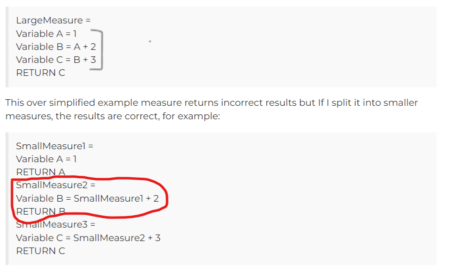

For example, one larger measure can be:
LargeMeasure =
Variable A = 1
Variable B = A + 2
Variable C = B + 3
RETURN C
This over simplified example measure returns incorrect results but If I split it into smaller measures, the results are correct, for example:
SmallMeasure1 =
Variable A = 1
RETURN A
SmallMeasure2 =
Variable B = SmallMeasure1 + 2
RETURN B
SmallMeasure3 =
Variable C = SmallMeasure2 + 3
RETURN C
If I then use small measure3 in a table, it returns correct results, but LargeMeasure’s results would be incorrect. Why is that?

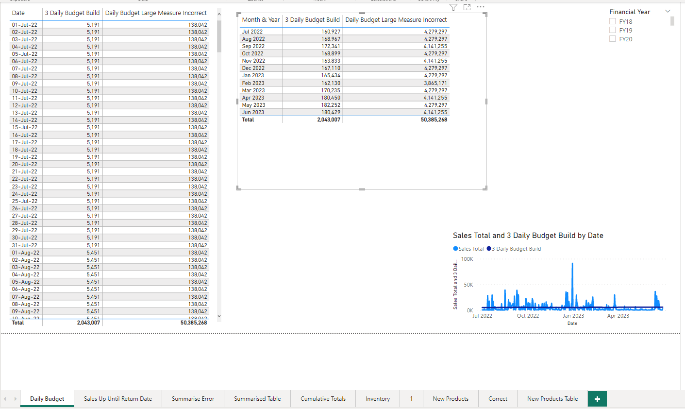

My sample file attached sheet “daily budget” contains tables where the incorrect results are displayed:

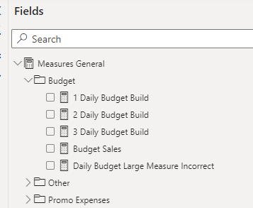

“3 Daily budget build” is the correct result but “daily budget large measure incorrect” is the incorrect result. Both measures use the same DAX to get to the result but the “3 daily budget build” is split into 3 parts, being
1 daily budget build
2 daily budget build

Hi Timmay,
Hope my feedback finds you helpful.
What I have understood by seeing your queries is at what level you are using measure branching.
So if I oversimplify it in LargeMeasure when you return C in LargeMeasure you have a value from Variable A to B and the independent C value is also there. That is why you are facing an extra amount in LargeMeasure.
on the other hand in SmallMeasure when you are returning variable C you are just adding the number of only SmallMeasure2 and the independent value.
So in LargeMeasure you are summing from the start of the measure and in SmallMeasure you are just summing the number from the previous step.
I hope I added something valuable.
