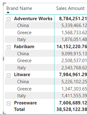

What properties do I have to modify to get Brand name display like image below
so I can have the option of expanding or collapse sections.
I have added the BrandName and country to the rows but what properties do I have to modify

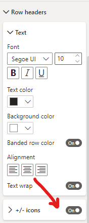

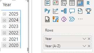

Perfect!
With multiple fields in the Rows section:
You’ll find the option in the Row Headers section, depicted below.
I hope this is helpful
