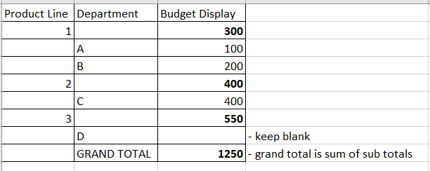

Thank you for your reply! I am actually looking for the total value to be 1,250 (300 + 400 + 550)

Here is what I am trying to do:
I guess that’s the outcome needed.
Budget Test (1).pbix (32.3 KB)
This is great- thank you!!
