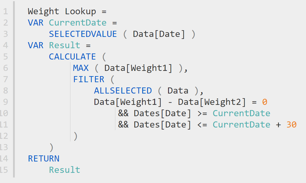

It’s a bit difficult to provide a specific answer without seeing a PBIX with your data model, but I would suspect that something close to this should work
If it doesn’t, please provide your PBIX work in progress, and I’ll be glad to work through a specific solution.
I hope this is helpful.

I can confirm the solution provided by @BrianJ is working.
Many thanks for your help.
