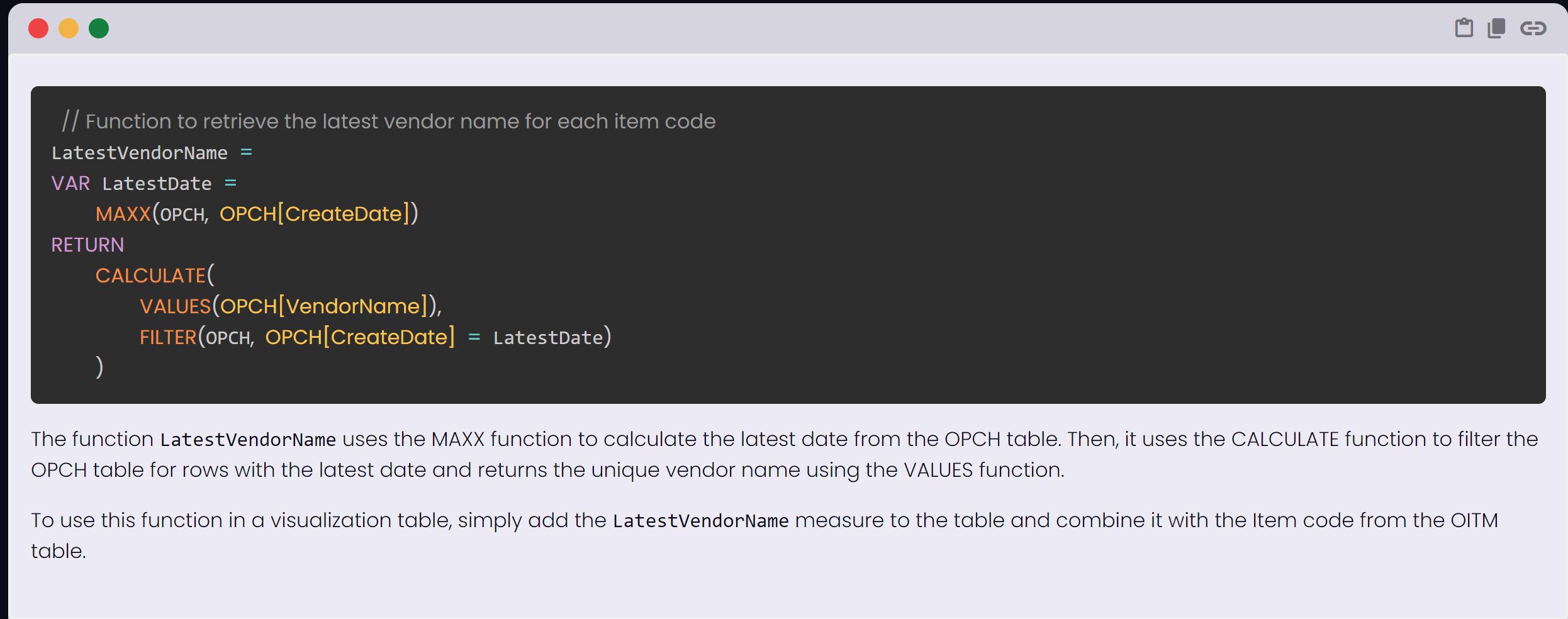

I tried Data Mentor to solve this and this was the feedback:
However, when I implemented the measure worked fine but I had issues creating the table.

@michael.wescott7226,
Try this revised version of LatestVendorName:
LatestVendorName =
// The original version of this measure was intended to retrieve the latest vendor name
// for each item code. However, it incorrectly calculated the latest date across the entire
// 'OPCH - A/P Invoice' table, not per 'ItemCode'. This led to inaccurate results when
// trying to find the latest vendor for each specific item code.
// Original version:
// VAR LatestDate =
//     MAXX('OPCH - A/P Invoice', 'OPCH - A/P Invoice'[CreateDate])
// RETURN
//     CALCULATE(
//         VALUES('OPCH - A/P Invoice'[CardName]),
//         FILTER('OPCH - A/P Invoice', 'OPCH - A/P Invoice'[CreateDate] = LatestDate)
// The revised measure correctly addresses the requirement by first determining the latest
// 'DocEntry' for each 'ItemCode' in 'PCH1 - A/P Invoice Rows' and then using this to find
// the corresponding latest vendor name in 'OPCH - A/P Invoice'. This approach ensures
// that the latest vendor is calculated for each specific 'ItemCode', adhering to the
// relationships between the tables.
// Capture the current 'ItemCode' from the 'OITM: Item Information' table
VAR CurrentItemCode = SELECTEDVALUE('OITM: Item Information'[ItemCode])
// Calculate the latest 'DocEntry' for the current 'ItemCode' in 'PCH1 - A/P Invoice Rows'
VAR LatestDocEntry =
    CALCULATE(
        MAXX(
            FILTER(
                'PCH1 - A/P Invoice Rows',
                'PCH1 - A/P Invoice Rows'[ItemCode] = CurrentItemCode
            'PCH1 - A/P Invoice Rows'[DocEntry]
// Determine the latest vendor name ('CardName') from 'OPCH - A/P Invoice' based on the
// latest 'DocEntry' identified for the current 'ItemCode'
VAR LatestVendorName =
    CALCULATE(
        MAXX(
            FILTER(
                'OPCH - A/P Invoice'[DocEntry] = LatestDocEntry
// Return the latest vendor name for the current 'ItemCode'
RETURN
    LatestVendorName
This measure may require some tinkering around on your part, but the idea should be clear.
