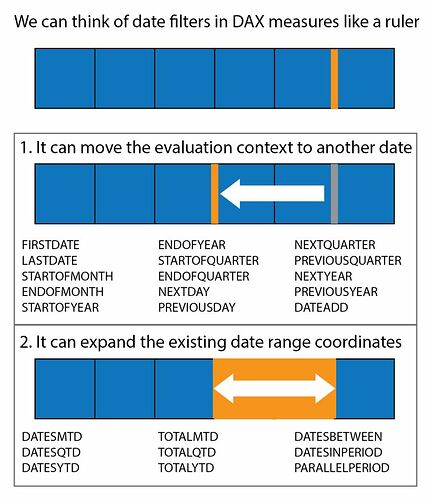

Hello @DavieJoe,
Today, I came across one of the post over LinkedIn and I think you’ll find this one very helpful while evaluating or shifting the date contexts in your measures. Below is the link of the post provided for the reference.
Hoping you’ll find this post helpful for future references. :slightly_smiling_face:

Thanks Harsh, very kind, I did spot this on LinkedIn and I saved it down for later reading.
I will check it out.
