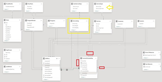

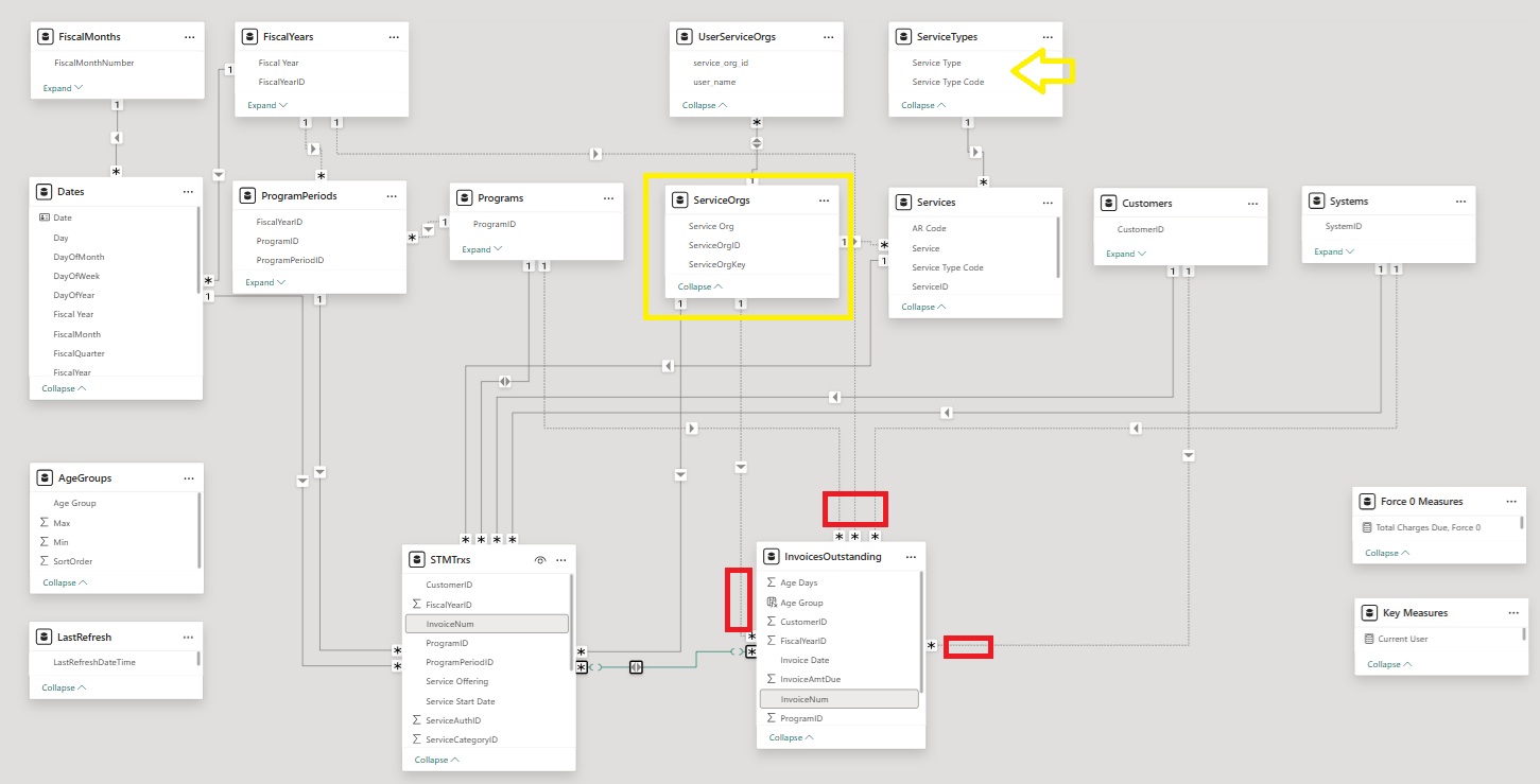

My issue involved having 2 fact tables, each connected to multiple dimensions, one of which had a bi-directional relationship which was allowing 2 possible pathways to one of the fact tables when filtering on a specific dimension. A screenshot is included below. The offending table for me was ServiceOrgs, and the filter dimension was ServiceTypes (both indicated in yellow).
It’s not easy to tell, but you can’t get from ServiceTypes to Services to fact table 2 (InvoicesOutstanding), so the actual filter path went from ServiceTypes to Services to fact table 1 (STMTrxs) then up to Programs via bi-directional relationship and then back down to fact table 2 (InvoicesOutstanding). And yeah, I had to stare at it for a while :P.

For my situation, I was actually able to directly link the two fact tables by one field (an invoice #, creating a many to many relationship between transaction-level details and outstanding invoices - relationship arrow highlighted) and then inactivate all dimensions on the second fact table (red circled items). I left the existing bi-directional relationship in place because I needed it for something years ago when I built the report. And boom, it worked on my desktop and the server, for all filter scenarios I could think of.
