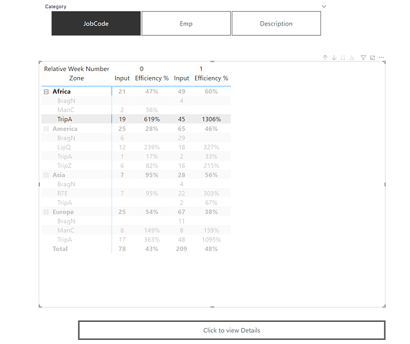

Hello!
I am authoring a measure that uses ISINSCOPE Function. This function looks if a particular category is in scope and if it is, it returns the MAX for that measure otherwise, it returns the SUM of the measure thereof.
The outside scope total works perfectly but in scope total for the category is not working.

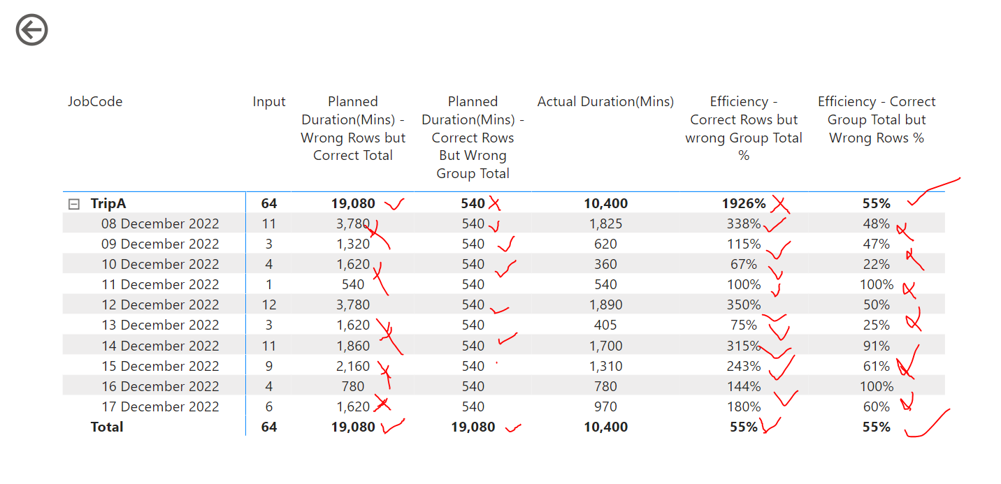

As seen from the image above, I am expecting the total to be 19,080 for the TripA total but what I get is 540 and therefore my Efficiency calculation is wrong. This should be in sync with the total row.
The image above is accessed from a drill-through page:

Explanation:
The planned Duration column is to return the maximum minutes per row for that particular day but when it comes to “totaling”, it is Input * the MAX of Planned Duration per row
I do need help with this, please.
