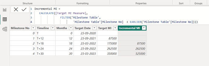

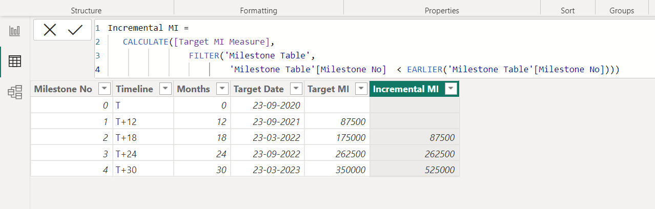

image attached with formula used:-
Incremental MI =
CALCULATE([Target MI Measure],
FILTER(‘Milestone Table’,
‘Milestone Table’[Milestone No] < EARLIER(‘Milestone Table’[Milestone No])))
But not getting desired result.

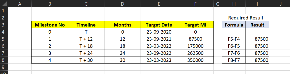

Required result
0 - 0
1 - 87500
2 - 87500
3 - 87500
4 - 87500

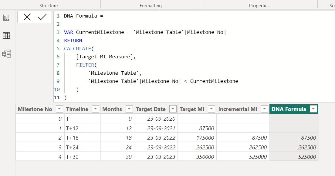

@vikashmukim Can you try this?
Incremental MI =
VAR CurrentMilestone = 'Milestone Table'[Milestone No]
RETURN
CALCULATE(
    FILTER(
        'Milestone Table',
        'Milestone Table'[Milestone No] < CurrentMilestone
Let me know if that works for you. Thanks
tried, not working.
screenshot attached.

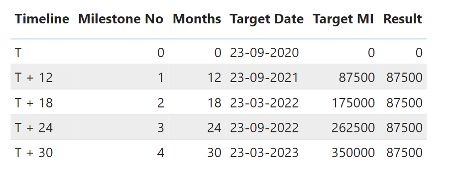

@vikashmukim Please see the attached solved PBIX.
I hope this is something you were looking for.
Do let me know if that works for you. Thanks
SOLVED Mi - Working 2.pbix (22.5 KB)
