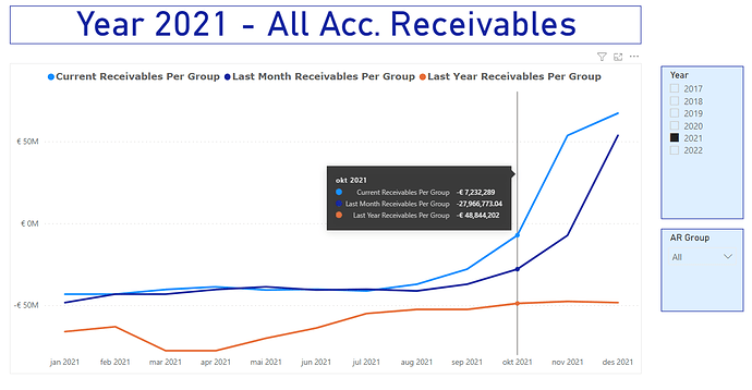

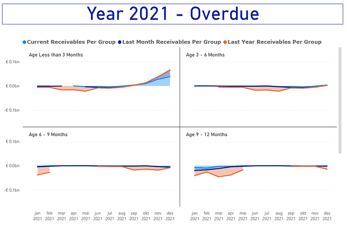

Hi @arve.haugland (v2)
Thank you for the feedback, and the help with the formula.
After some further testing, including your sample, the total Accounts Receivable AND the split into segments / AR Aging groups, works fine, for the Current period, Last month and for Last Year.
PBIX 3x attached:
Customer Receivables DEMO DS v2_2 ArveHaugland.pbix (407.5 KB)
Cust Receiv DEMO DS audit Oct sample v2.pbix (359.4 KB)
Customer Receivables DEMO DS v3.pbix (1.2 MB)
Easily to check in the page “Aging over periods” in each of the PBIX files.
- Just to be able to verify the calculated amounts per AR aging segment /bucket, as presented in the report, calculated columns are added for Receivables and Aging for Oct, Nov and Dec 2021 in the table ‘ARFBL5N’ in "Cust Receiv DEMO DS audit Oct sample v2.pbix "
All measures are based upon the same filter selection, see four of the six measures used below,
