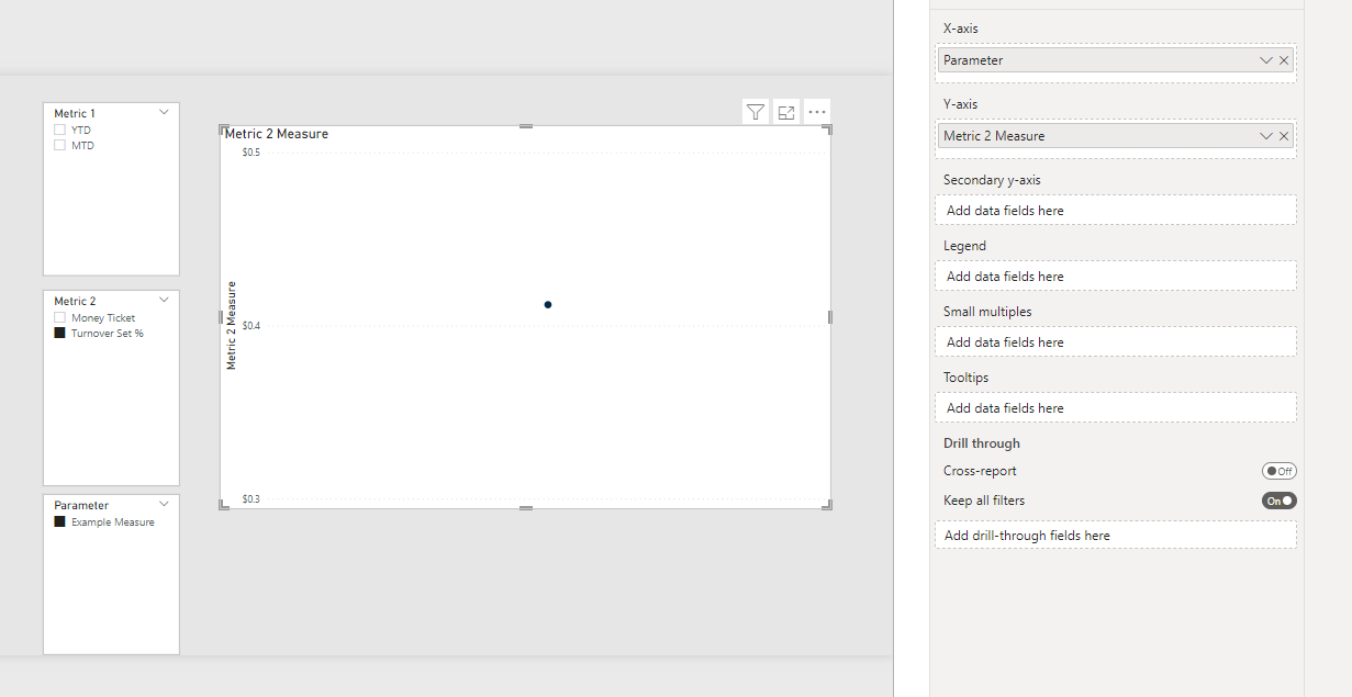

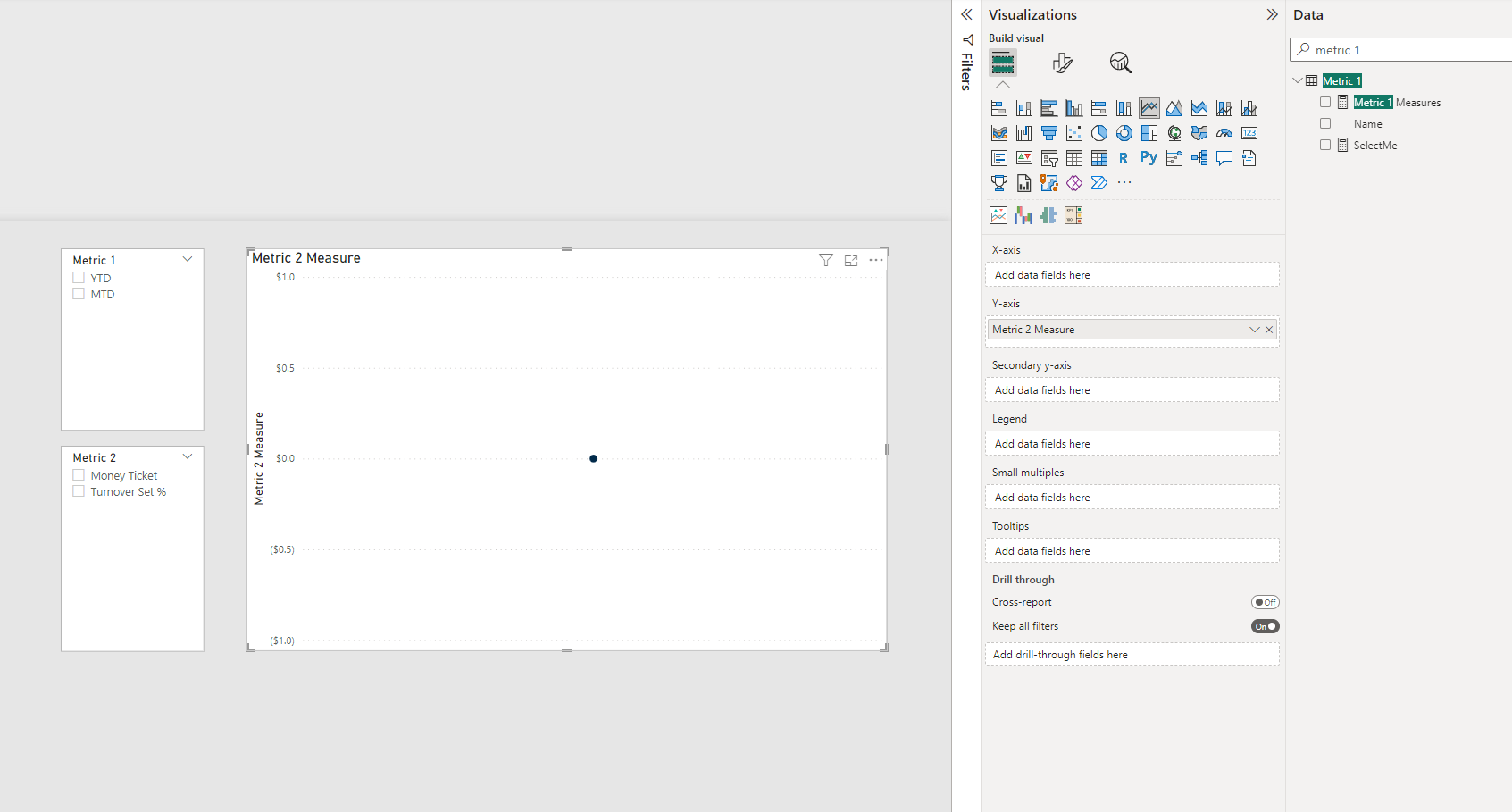

Hi all, I’m wanting to use a line chart with 2 calculation groups; one to change out the y-axis (Metric 2),and one to change out the x-axis (Metric 1). The problem is that I can’t use a measure in the x-axis, I’d have to use either a column or calculated column. I want to be able to use a line chart and then switch out the x-axis to view measures on a YTD and MTD time horizon. Any ideas on how i’d be able to do this?

I’m having issue trying to set this up though. I was thinking of trying to combine a calculation group with the field parameter.
I was thinking I could pass whatever measure is selected in the calculation group (Metric 2) to the field parameter (Parameter). The only field I have in Parameter is the following DAX:
CALCULATE(
    ISSELECTEDMEASURE([Metric 2 Measure]),
    FILTER(
        ALLSELECTED( 'ARS PBI_Calendar' ),
        'ARS PBI_Calendar'[CalendarDate]
            <= MAX( 'ARS PBI_Calendar'[CalendarDate] )
Metric 2 Measure = 0
What would be a way to set this up?

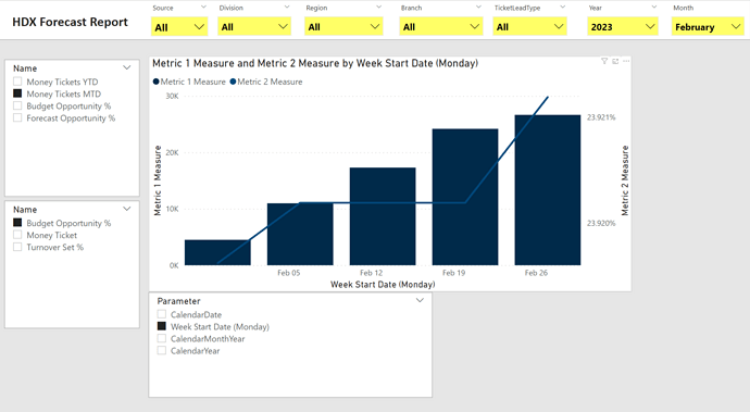

UPDATE/SOLUTION:
Thanks to @AntrikshSharma for the reccomendation.
I ended up using a calculated group for the metrics/measures and used a field parameter for the x-axis/time series and it works perfectly.
