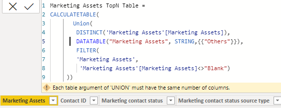

The filter getting rid of Blanks canāt be the first argument in a CALCULATETABLE function. The first argument has to be a table. if you put the filter in the second position do you get the same error?
I get this error now. It states each table argument of āUnionā must have the same number of columns.

To get it working, itās not ideal, but you can calculate another table by referencing the current one with:
Marketing Assets Calculate = CALCULATETABLE(āMarketing Asset TopNā,FILTER(āMarketing Asset TopNā,āMarketing Asset TopNā[Marketing Assets] <> āBlankā))
Let me play around to try and avoid needing two tables.
It must have been syntax, as I just got this to work in the original table:
Marketing Asset TopN =
CALCULATETABLE(UNION(
DISTINCT(āMarketing Assetsā[Marketing Assets]),
DATATABLE(āMarketing Assetsā,STRING,{{āOthersā}})),FILTER(āMarketing Assetsā,āMarketing Assetsā[Marketing Assets] <> āBlankā)
