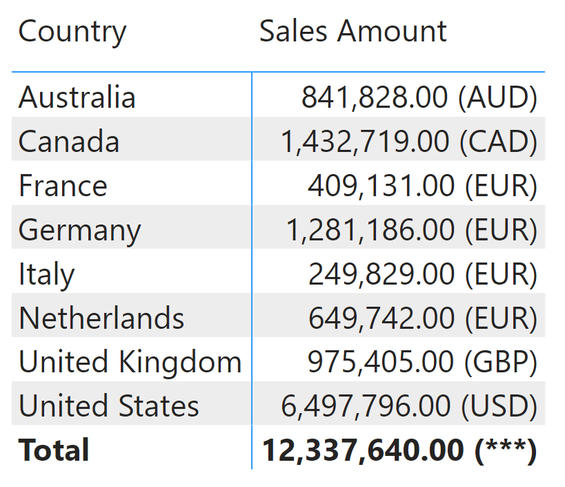

Hi @Bq1BQfLi - For this to work, you need to make formatting of “Selected Metric Test” dynamic. For this refer to newly introduced “Dynamic formatting” option by Power BI in April 2023. Refer to SQL BI article or other similar ones available online.
if still face issues, share sample PBIX file and I can try for you.
