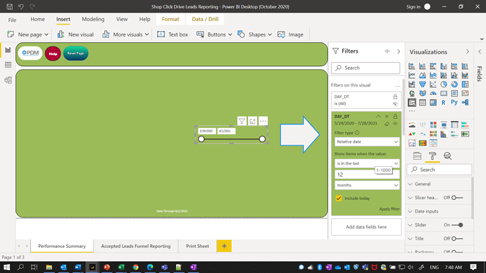

@tej ,
Just have to setup your slicer a bit different.
Here are steps in pictures:
Jarrett
Hi Jarrett,
Thank you so much for your reply. Earlier I have showed this option to client but they are not interested to use relative date filter. Because they want to see the data ranges and flexible to change and verify the date periods using the date between filter it seems :-(.
