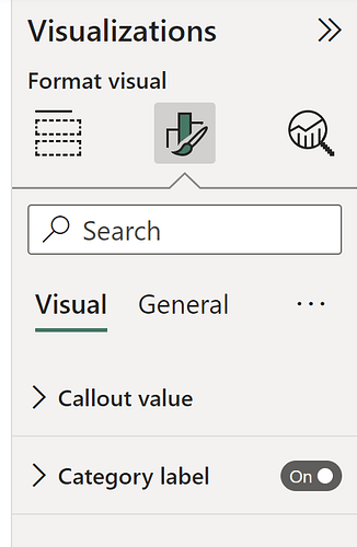

I do not see the data label option.
This is what I see when I select the card visual

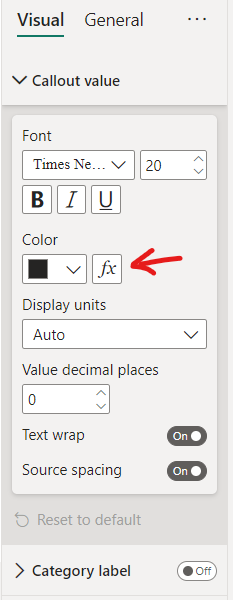

@arkiboys It’s there if you expand the Callout Value.
Please follow these steps.
@arkiboys Further to my above message. I can see the formatting option when expanding the Callout Value.
