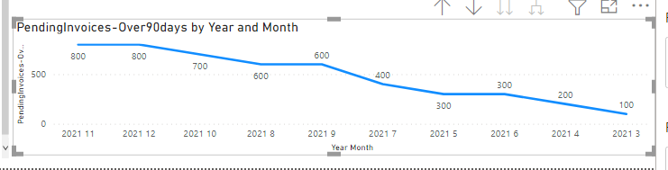

I need to track historical values of over 90 days late invoices. I’ve attached a sample file with the expected results. Based on invoice due dates and payments, I had 2 invoices, 2 and 3, which were over 90 days late on April 1, 2021 and were not paid. Then by May 1, 2021, I had invoices 5,6 and 7 that were not paid and over 90 days old.
I’ve created measures to track historical monthly unpaid invoice amounts but need to create a measure to track just the over 90 days unpaid invoice amounts to match the bar chart I provided.
Hi @Usates - This is the same issue raised earlier but with better explanation. Still an example of Calculation would have been really helpful. Also, you mentioned 2 and 3 for April 1, 2021. This is again Incorrect, as those invoices shall be 4,5.
Anyways, I think I have got the requirement after spending good amount of time and the solution for same. Please try below. Output is matching with the count given.
PendingInvoices-Over90days =
VAR slicedByDate = min(DateTable[Date])
var PayTab = SUMMARIZE(filter(All(AR),AR[Type] = “Payment” && [date] <= slicedByDate),AR[Doc Num])
var InvTab = SUMMARIZE(filter(All(AR),AR[Type] = “Invoice” && [date] <= slicedByDate),AR[Doc Num])
var PendingInvoices = EXCEPT(InvTab,Paytab)
var PendingInvoices_Over90days = filter(all(AR),AR[Doc Num] in PendingInvoices && AR[Type] = “Invoice” && datediff(AR[Date],slicedByDate,DAY) > 90)
return
sumx(PendingInvoices_Over90days,AR[Amount])
