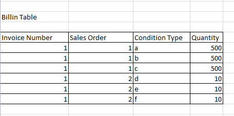

I have a billing table
I have a measure
[Billing quantity] =
VAR NumberOfRows = COUNTROWS(‘Billing Table’)
RETURN
SUM(‘Billing Table’,DIVIDE(‘Billing Table’[Quantity],NumberOfRows)
I thought this worked but on finding two sales orders with different quantities this no longer works
The report Shows the calculation at row level.
How do I get the calculation to get the value for each sales order and then add those two values?

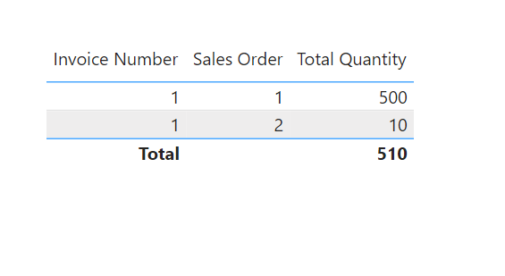

Hello @ells,
In order to achieve the results based on the scenario that you’ve provided in your original post. Below is the DAX measure alongwith the screenshot of the final results provided for the reference -
Total Quantity =
SUMX(
    ADDCOLUMNS(
        SUMMARIZE(
            'BillingTable_S1' ,
            'BillingTable_S1'[Invoice Number] ,
            'BillingTable_S1'[Sales Order] ) ,
        "@Total_Quantity" ,
        CALCULATE( MIN( 'BillingTable_S1'[Quantity] ) ) ) ,
    [@Total_Quantity] )
Final Results
Thanks and Warm Regards,
Harsh
Sum of Total Quantities - Harsh.pbix (21.4 KB)
