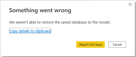

Hi @Clolawra,
Thank you very much for posting your query in the forum.
When opening the pbix file I get this error:

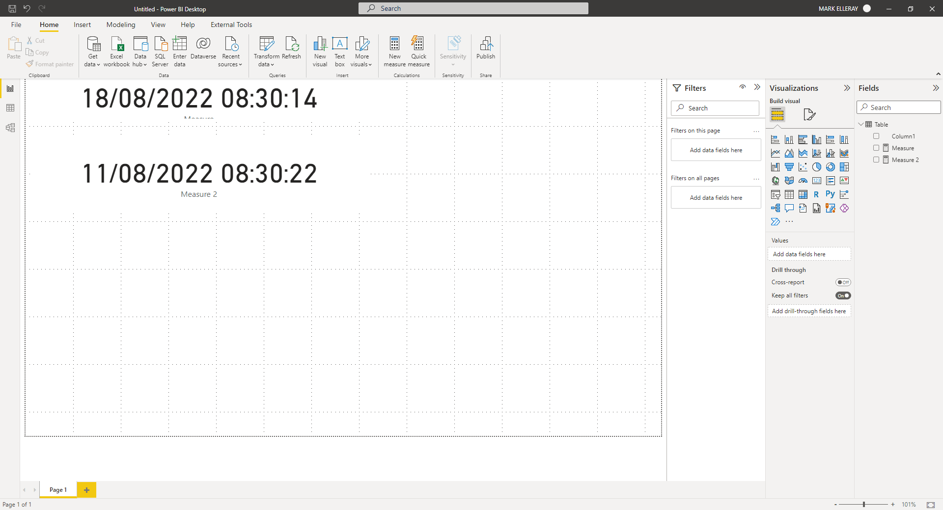

@Clolawra
You could use the following to get the right numbers
CurrentDateTime = Now()
LastWeekDateTime = [Measure]-7
Then you can get yor data by f
filter on the datetime >=LastWeekDateTime
&& datetime <=CurrentDateTime
Even if you donty like this as a solution it will help teest Week to date querys.
Hope that helps
Ells

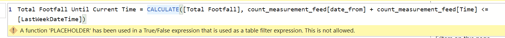

Hi @ells,
I have just tried to give that a go however I get the following error - I think because I am using a measure in the filter?
Do you have any idea if there is a better way for me to run the filter?
Thank you,
Chloe
