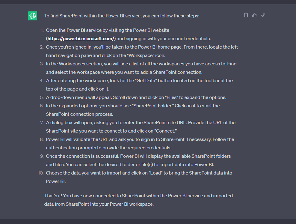

Here is the process when i use chatGPT

did you read my comment about the service? chaygtp
