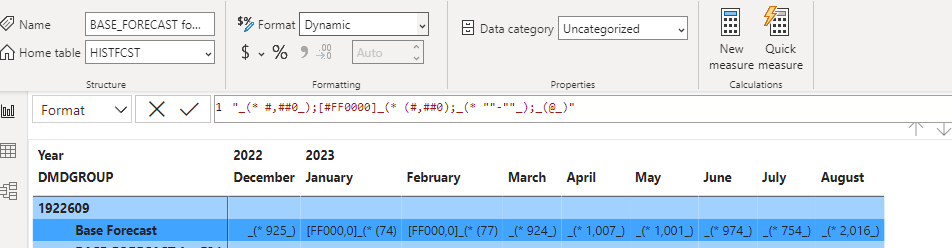

I have an excel that is formatted such that negative numbers are in red in color and in brackets and one decimal place as shown below
I have been trying to replicate in Powerbi by going to the formatting options but i dont seem to get through
image. I even tried the EDNA option https://www.youtube.com/watch?v=QlvvoF_xDtY but i dont know why its not working

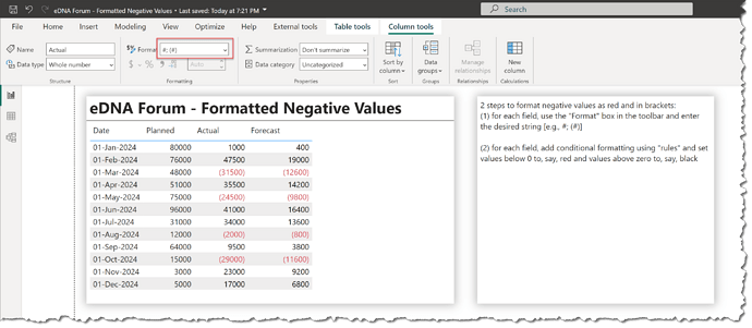

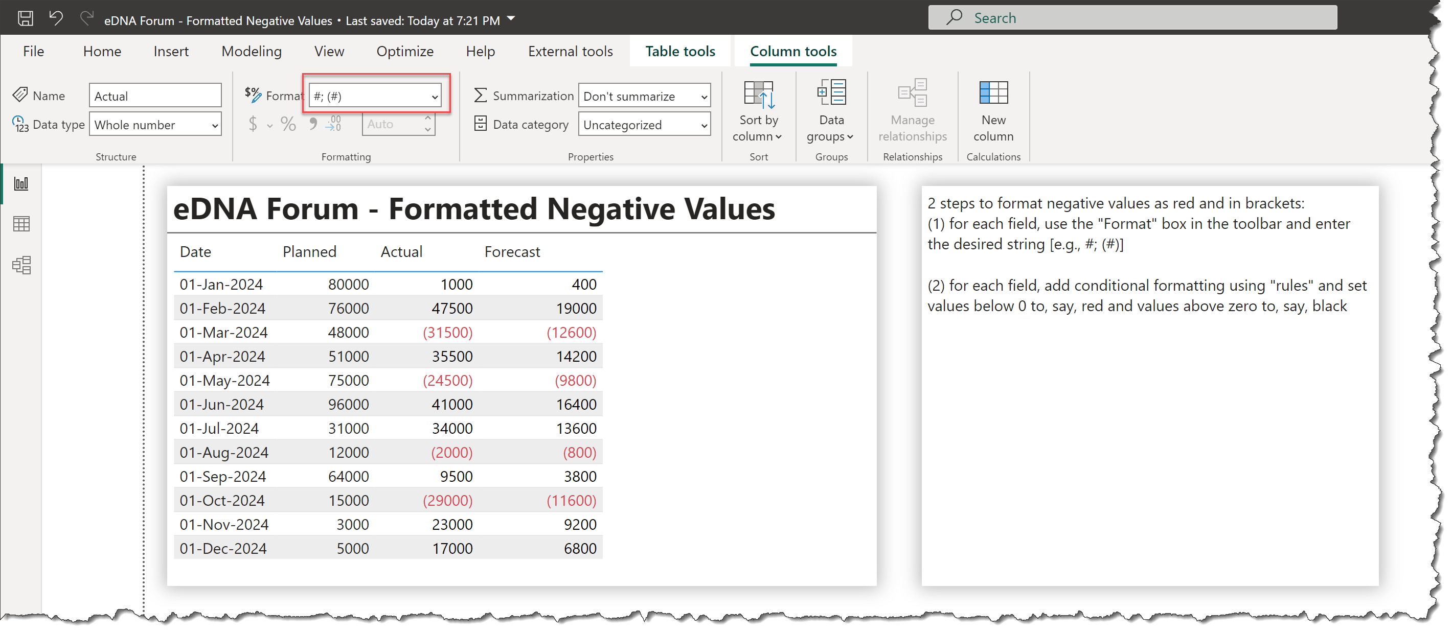

You can format negative values as red and in brackets using a 2-step process:
(1) for each field, use the “Format” box in the toolbar and enter the desired string [e.g., #; (#)]
(2) for each field, add conditional formatting using “rules” and set values below 0 to, say, red and values above zero to, say, black
Hope this helps.
Greg
eDNA Forum - Formatted Negative Values.pbix (19.7 KB)

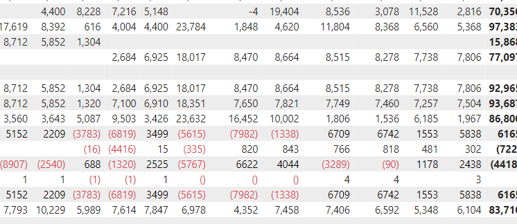

Sorry for another ask, How do i make the blank values as a dash like in the excel
this is what i have now in powerbi.
HI @wilford.mitchell. There are 3 parts to the format string: positive, negative, and zero. Adjust as desired (say [#; (#); -]).
