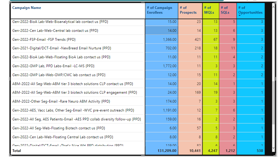

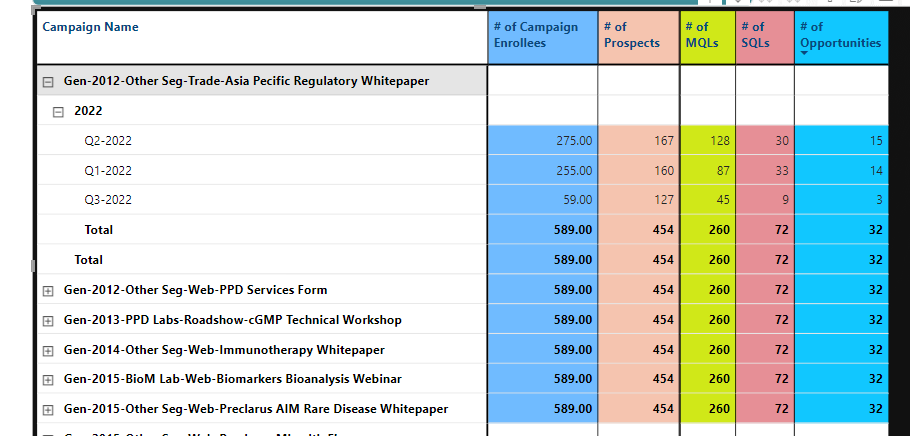

Hi,
I am having difficulty coming with a formula to correct my totals in a table with multiple rows. As an example, in image #1, this is the correct total with only one value in the Row. In Image #2, when I add a date hierarchy, the total is incorrect. Image #3 is the formula I am using.
Can anyone help? Thanks in advance
Image#1
Image #2
Image #3

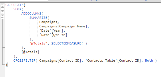

Here is the solution for anyone else. I will add in Analyst Hub.
SUMX (
SUMMARIZE ( Campaigns, Campaigns[Business Segment of Interests], Campaigns[Campaign Name],
‘Date’[Year], ‘Date’[Qtr-Yr]
CALCULATE (
SELECTEDMEASURE (),
CROSSFILTER ( Campaigns[Contact ID], ‘Contacts Table’[Contact ID], BOTH )
I am using Tabular Editor. You can just switch SelectedMeasure() with your measure.
