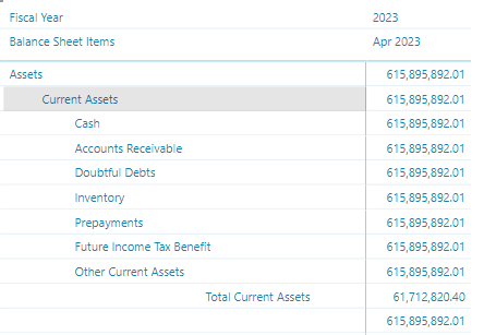

I can’t seem to get the totals to show using the template approach for financial reporting financial reporting. We have a different layout of tables than the demo.
I’ve attached some screen shots of the formulas and the template I am using.
Can you help? Let me know if you need more info.

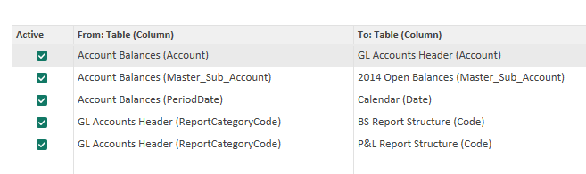

From Manage Relationships
I hope these sample files help. This is just one line for current assets, so you can see if anyone to get the ‘Total Current Assets’ line to bring in the total.

ok im getting closer, I had to remove the join between the BS report Structure. Now I have to fix the other subtotals.
I think I can solve it myself now.
