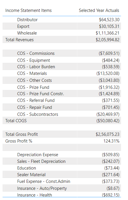

I am following the Financial Course, I need to get rid of this zeros. the measures is 100 as described by Sam in the course, his table seems OK but mine produces this zeros where should be blank.!
Any idea what am I going wrong. I have tried wrapping it up with and IF (…) and I have tried BLANK() at the ned of the measure but to not avail?
Zeros|333x500 ZerosDAX

Hello @FPastor,
Thank You for providing the working PBIX file.
So the problem was in the base measure that you’ve created for “Income Values”. You’ve added constant into the measure as “0”. Below is the screenshot provided for the reference -
Income Values Measure With Constant
Once you remove the “0” from the measure everything gets back to normal. Below is the screenshot provided for the reference -
Income Values Measure Without Constant
I’m also attaching the working of the PBIX file for the reference.

Thank you very much Harsh.
I use the +0 to avoid (blank) in single value cards.
The problem is sorted and I learnt one more interesting point.
