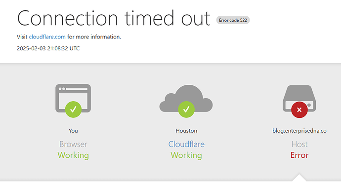

Is your website down? Just tried this link, and am getting this error.
Hi @sbarfuss ,
We’re aware of the issue and have already been investigating it. Our team is actively working on a resolution, and we’ll update you as soon as it’s fixed.
We appreciate your patience, and please let us know if you need anything else in the meantime.
