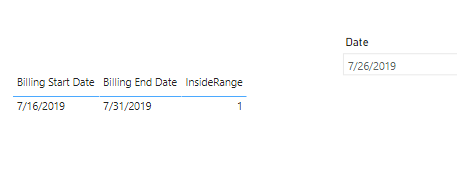

Lot of different ways to handle this one, but I went with the tried-and-true disconnected table approach:
  1. Created a table called Disconn Date using VALUES( Dates[Date] )
  2. Used the resulting field Disconn Date[Date] in my date slicer
  3. Created the following 0/1 measure to calculate which (if any) of the rows the selected date fell within
  4. Set the filter pane on the visual to only show rows where the measure = 1
    InsideRange =
     IF(
        AND(
            [Harvest Date] >= SELECTEDVALUE( Data[Billing Start Date] ),
            [Harvest Date] <= SELECTEDVALUE( Data[Billing End Date] )
        ), 1, 0
Here’s what it looks like all put together:
Note: you don’t need to include InsideRange in your visual - I did so just for illustrative purposes.
I hope this is helpful. Full solution file posted below.
