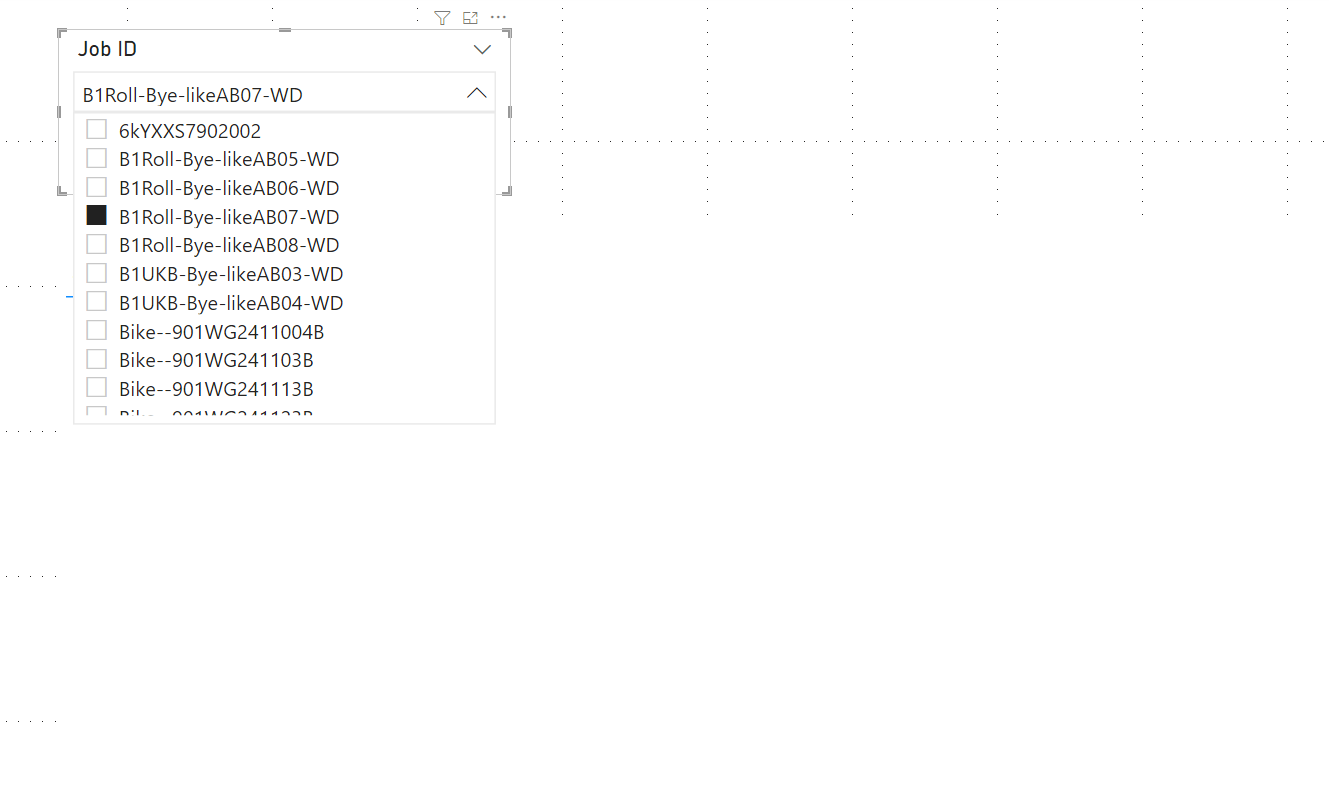

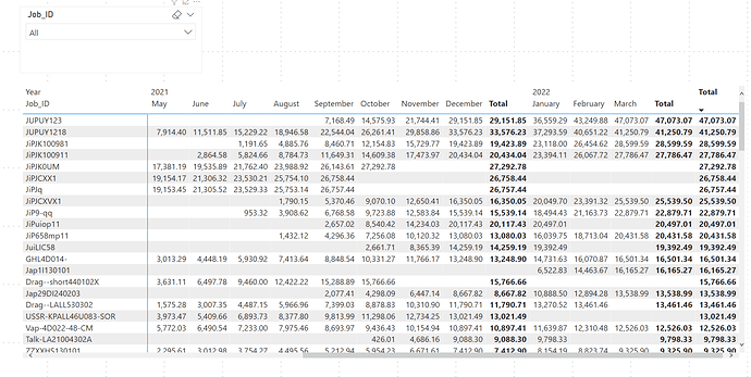

From the first image without any selection, the report is displayed but when you select a value on the filter as seen in the second image, nothing is returned.
Wondering what the issue might be
Project Hours Split.pbix (768.7 KB)
Thank you
Hi there,
Don’t you to have a filter statement using your job id. I only see your filter on date.
don’t know how to correct it as i’m weak on dax.
thanks
Keith
It is why I am asking the question too.

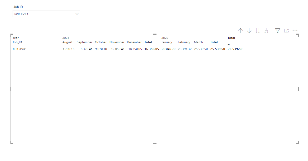

hi there…it works.
as you can see.
I just checked your filter on a couple of job id …there is nothing in your data as i can see.
keith
You are right Keith. There where blanks coming from the filters
good to help :slight_smile:
