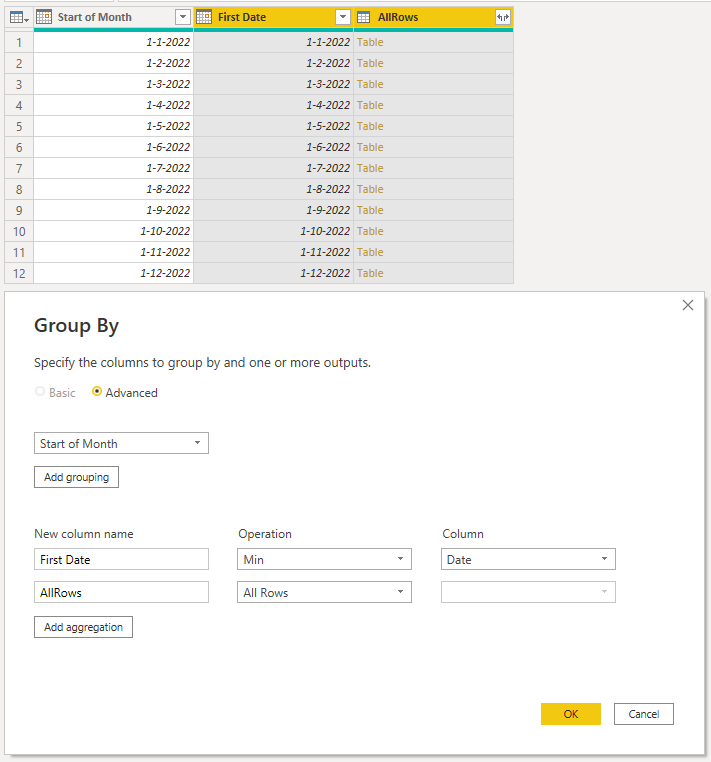

Hi @ZENMarkD,
Here’s an approach for you.
  1. Add a Start of Month column. Select your Date column, go to the Add Column tab: From Date & Time / Date / Month / Start of Month
  2. Select the Start of Month column and go to Group By / Advanced / Min over your Date column and add an aggregation to bring in all rows as well
  3. Expand the AllRows table to bring back additional fields.
I hope this is helpful.
Thanks so much Melissa. I think that’s done the trick. In addition to the above I added a custom column that compared the First Date column to the main Date column so I can filter out the rows that don’t match.
I’m having some data issues at the moment that is preventing me from confirming this, but it looks to have worked in Power Query so I can tentatively say it’s solved!
Thanks again!
I can now confirm this solution worked!
