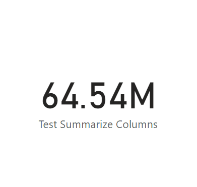

When you use a card visual, the only thing that you put inside a card is a “Measure” and nothing else i.e., no fields from any of the tables. And therefore, since card visual only works with the evaluation context, it’ll showcase you the results when you use the “SUMMARIZECOLUMNS()” function to calculate the results or totals. Below is the screenshot provided for the reference -
Result of "SUMMARIZECOLUMNS()" Function Inside A Card Visual

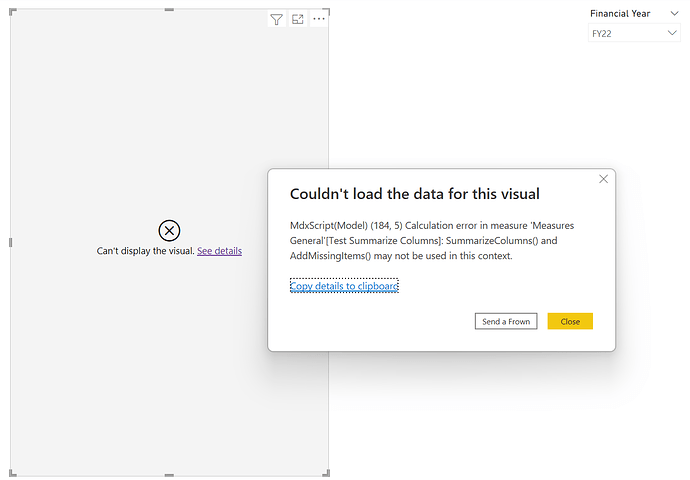

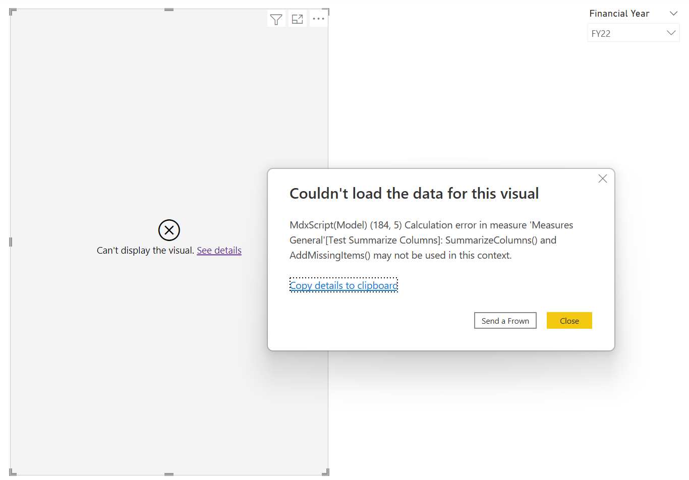

Now, when you convert this card visual in any other chart by adding fields from any of the tables that’s when “Context Transition” takes place. So for example, in your case, you wanted to evaluate the results Date wise by adding a date field inside the table visual. So in that case, it needs to evaluate the results for every single day and not at a Total Level and therefore, it failed to evaluate the results. Below are the screenshots provided for the reference -

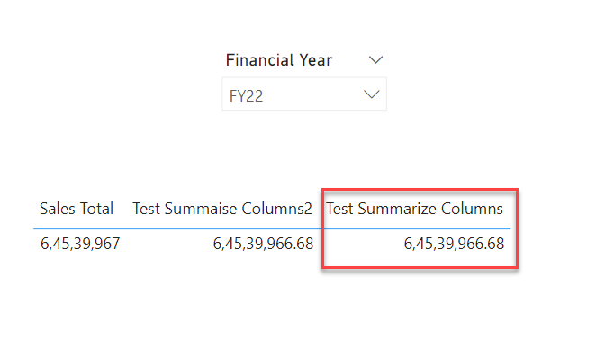

But now, when you again remove the Date field from the Table visual, it’ll calculate the results since there’s no context transition but only the evaluation context in place i.e., one single figure in the form of Totals. Below is the screenshot provided for the reference -
Result of "SUMMARIZECOLUMNS()" Function Inside A Table Visual At A Grand Total Level
