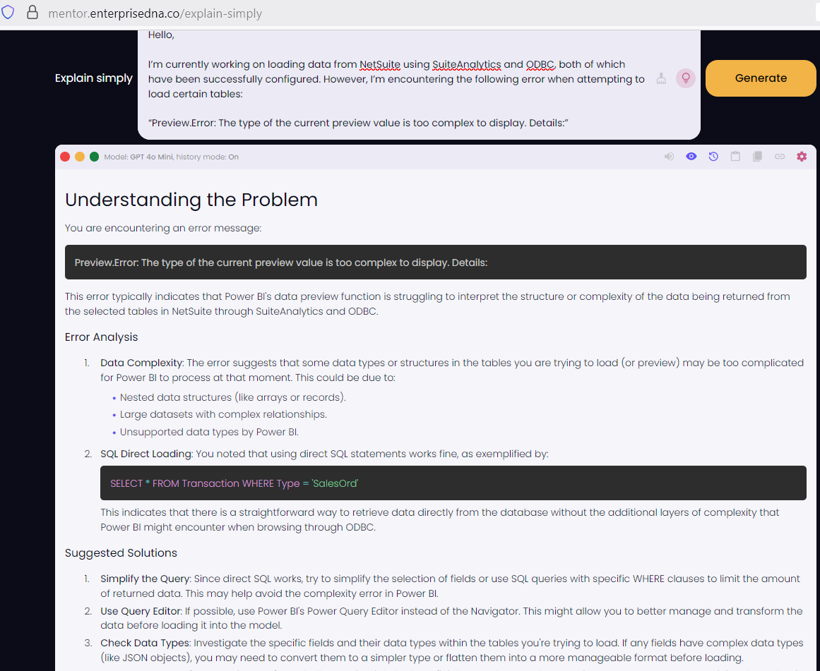

Hi @hadeeh ,
Thank you for reaching out to the community.

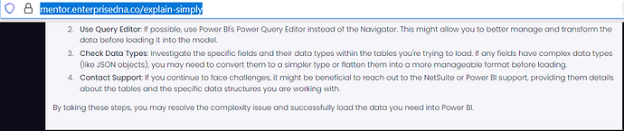

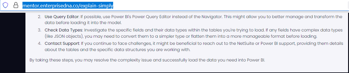

While we wait for other members to share their insights, we’ve taken the liberty of using “Explain Simply ,” one of the tools available within Data Mentor (you can explore it here: https://mentor.enterprisedna.co/explain-simply . It generated the following results:
Feel free to checkout more of our Data Mentor features as you work on your report. These tools are designed to help with tasks like the one you’re working on.
Cheers,
Enterprise DNA Support Team
Hi @hadeeh ,
Depends of what is behind * in SELECT statement.
Try to simplify the query to use exact fields as Data mentor propose and see if works.
For example sometimes CLOB type attributes can cause problem. Check if you have some of that kind of type and try to exclude form your query.
Good luck.
