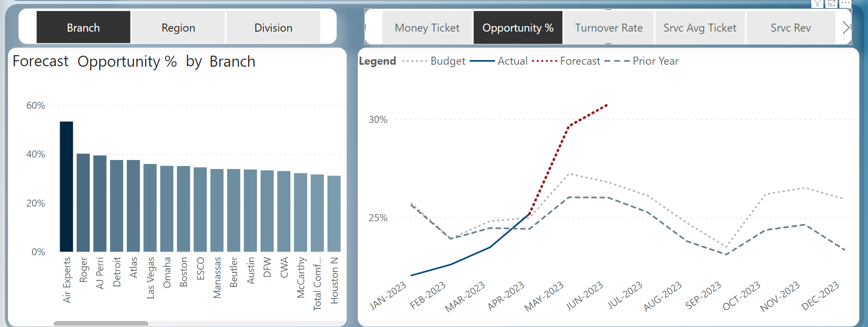

I’m trying to get a dynamic title to work with a calculation group where the calculation item name will change based off of the selection I make in a slicer.
In this case, I’d want it to say Money Ticket in the title. If I clicked on Opportunity %, I’d want it to say Opportunity % in the title.

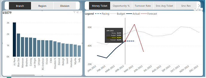

But when I use this measure as the title it gives me the numeric value and not the name of the calculation group item name

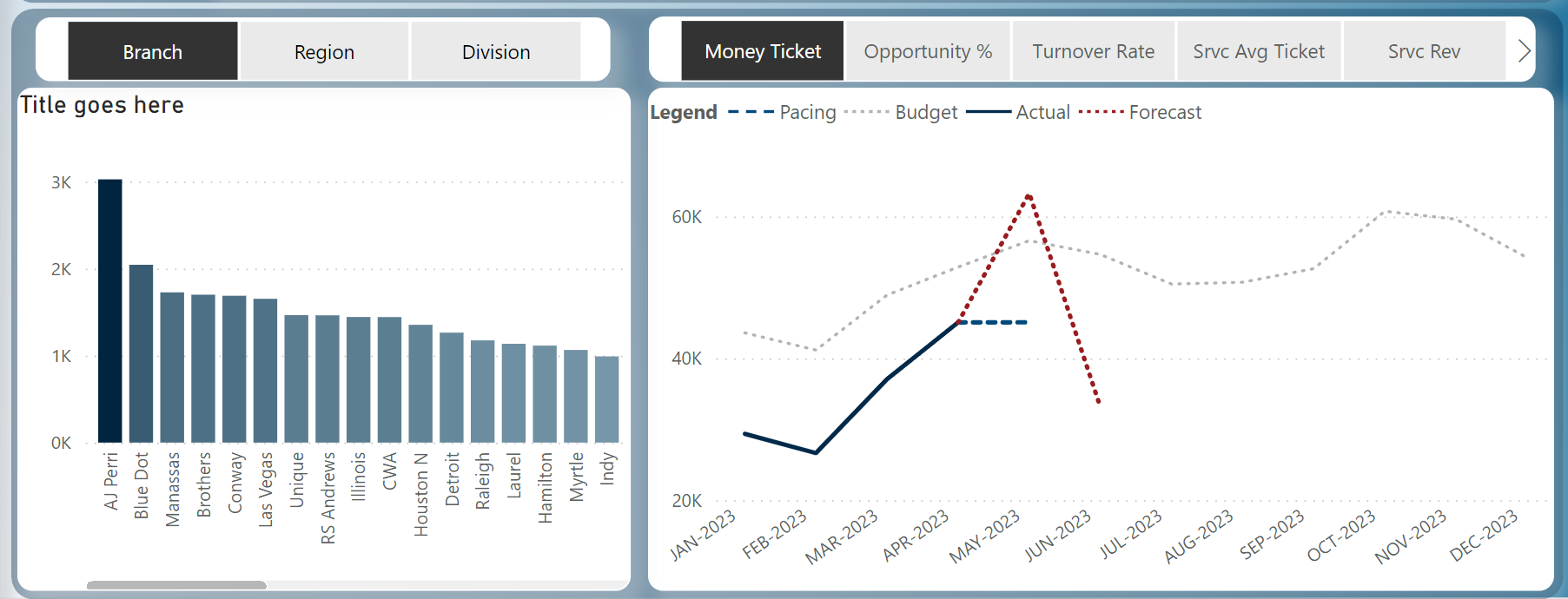

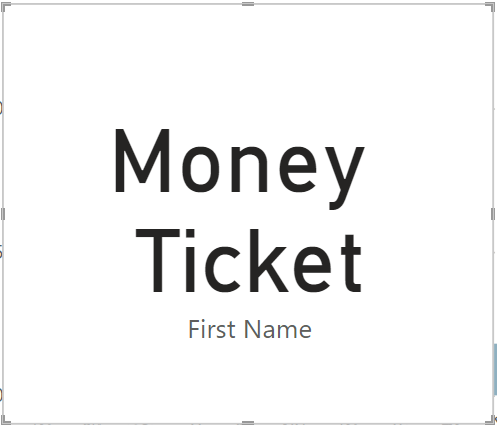

To get around this, you have to use the calculation group’s Name column that’s created when you created the calculation group itself. I just wanted the title to appear and not any kind of slicer or button. So I decided to use the Card visual, but when you do that you aren’t allowed to add the Name field from the calculation group. The trick is to create a slicer visual first, add the Name column, and then switch the visual to a Card visual.
I then doctor up the cards so that they look close to a title. So now you have dynamic title for calculation groups :slight_smile:
