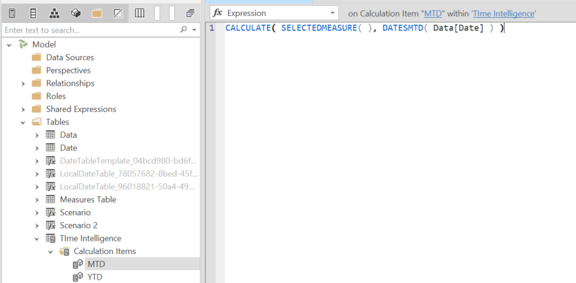

For this scenario I would use field parameters and calculation groups, The Budget, forecast switch is already handled with that so one less thing to do. So about MTD and YTD perspective, the calculation groups are created just for those type of scenarios.
Calculation logic will the the same that you are already using, just instead of a measure you will use selectedmeasure()
If you don’t want to use tabular editor then you can handle it with switch() function but solution above is generally speaking the most optimized from performance point of view.

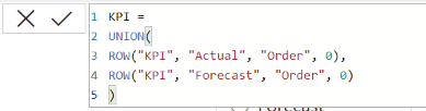

As said, switch method is slower in performance and you have no dynamic header but here it is.
First let’s change your “Scenario” table to regular one, that we can use in slicer
Then we will do switch based on selected value on KPI column. This is a measure created
Now we want to have a time intelligence based on it. So let’s change your “MTD” and “YTD” measure
And you can use “Scenario 2” fields and should work as intended

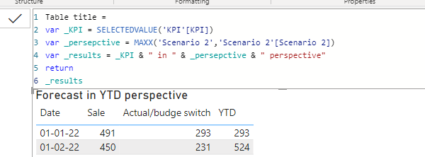

I did not notice your response,
you can use measure for table title. Try this
Table title =
var _KPI = SELECTEDVALUE('KPI'[KPI])
var _persepctive = MAXX('Scenario 2','Scenario 2'[Scenario 2])
var _results = _KPI & " in " & _persepctive & " perspective"
return
_results
