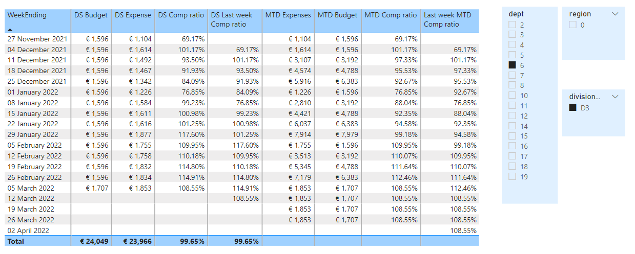

3 A possible report looks as follows:
Note 3: be aware to select the WeekEnding Date from the Date-table, not from the fact-table.
