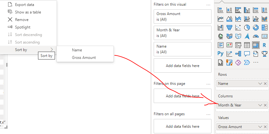

@ronald_balza - I recently find out that you can add a sorting measure in table (and matrix) and hide that column. There was also another trick.

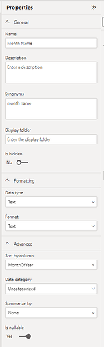

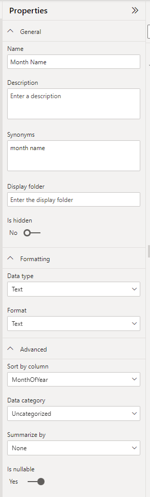

If you will use it all the time that kind of sort - it’s better to set this in model view (you can set up for Month&Year Sort by column which you want):
