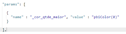

I created the parameter using the Power BI theme color, as below:
But when I try to use the expression below, it doesn’t work
If I replace the parameter with a Hexadecimal color, it works perfectly, but I would like to use the parameter, does this possibility exist?
Hi @domingo42. My understanding is that the Deneb-specific pbiColor syntax is only available when used directly within an expression. For more details, see the Deneb documentation:
Hope this helps.
Greg

Thank you for the quick response, the documentation does not really mention this possibility.
hi @jeanrose87 Thanks for the feedback, I just put Greg’s answer as a solution.
