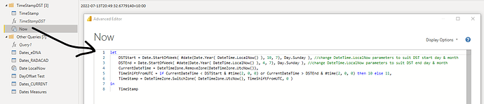

I have a dates dimension with a ‘dayoffset’ column mostly to identify the current date for time intelligence calculations (e.g. dayoffset <= 0). Never had any issues with this before and have been using the same M function for a few years now. Recently, dayoffset = 0 is showing as the previous day in the Power BI service. I download the dataset, refresh the dates table which corrects this then upload the dataset again but when the dataset refreshes, it reverts back. I’ve done the corrections for UTC in power query. Even my timestamp datetime calculation is correct. I’ve uploaded a test report with four dates tables.

I see a couple of different M functions used to determine: “now”
My suggestion would be to replace that with: DateTimeZone.FixedUtcNow
So create a separate query: UTCnow = DateTimeZone.FixedUtcNow()
You can offset that to your timezone, refer to this query in all instances of your code so it’s only executed once. Other things to keep in mind.

Thanks @Melissa. Can you highlight in the query where you would make these changes please?
Hi @mkaess,
Like described above, create a single query you can refer to multiple times.
Examine your code and where the Current Date and/or Time are required enter a reference to that instead. For example below is illustrated how to get the CurrentDate from the “Now” query.
I hope this is helpful
