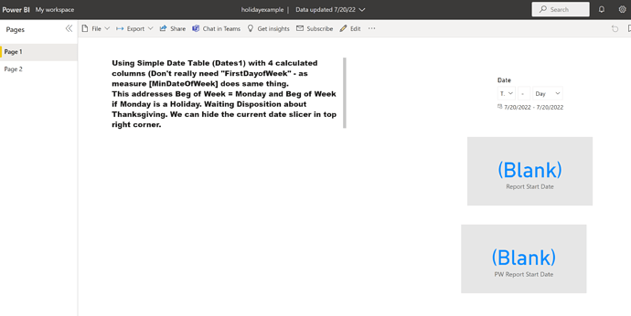

I have set the date slicer as relative (This Day) and have a measure that works. I also want to calculate the previous weeks start date(with the same criteria). These are the two measures that work fine on Desktop but go blank on service.

Well, we are also facing quite a weird or strange problem. That is, when I downloaded the file and published it straight away onto the Web Service, it gave me the results as blanks but when I re-published it again, it started to showcase the results correctly. Below are the screenshots provided for the reference -

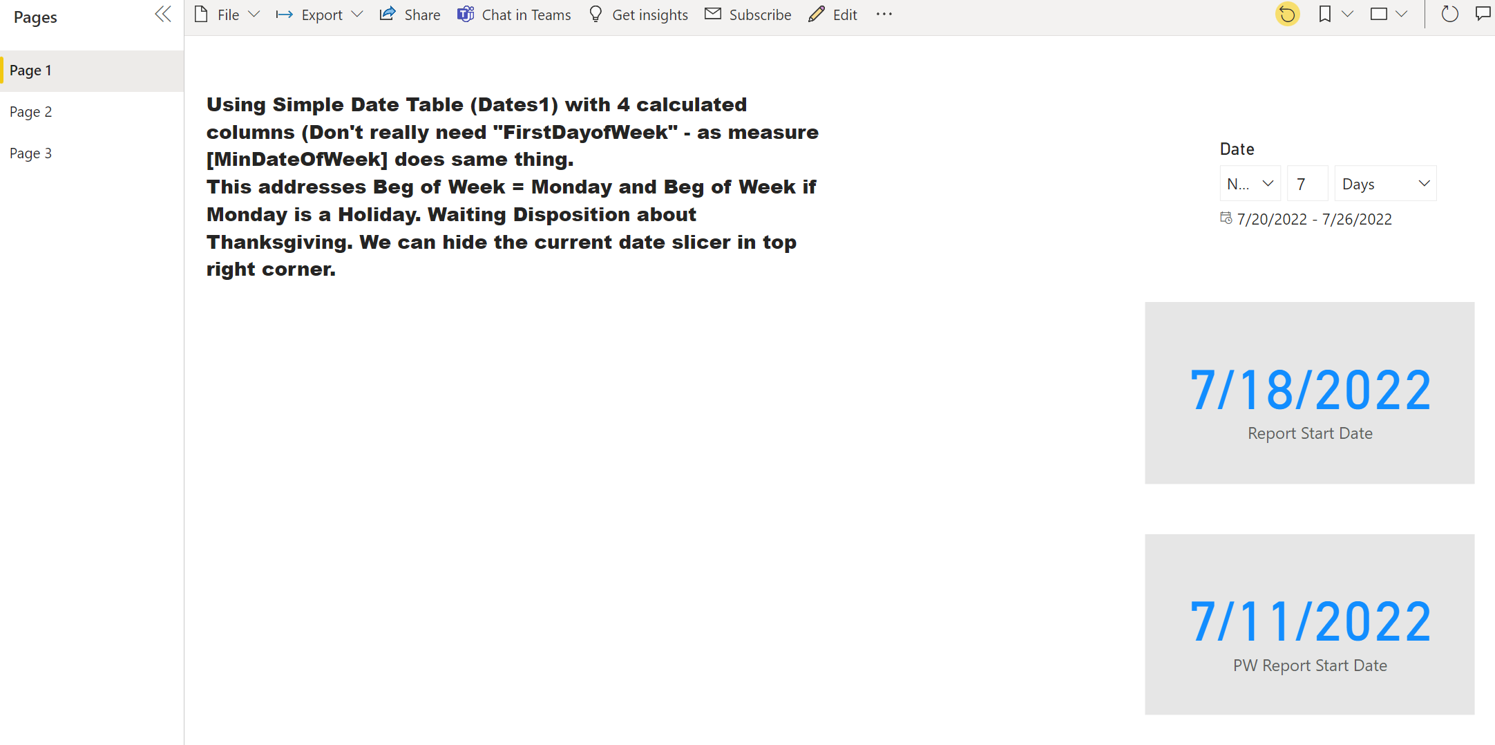

As you can see in the above screenshot, it gives the results as blanks. This actually happens when it’s published for the first time. But now, when it’s re-published again, it showcases the results. See below screenshot -
I crossed check the exact the same issue with my expert colleagues as well who are located in different time zones and they also witnessed the same thing. So can you also try the same on your side as well by re-publishing it?

Below is the screenshot of the final results provided for the reference -
